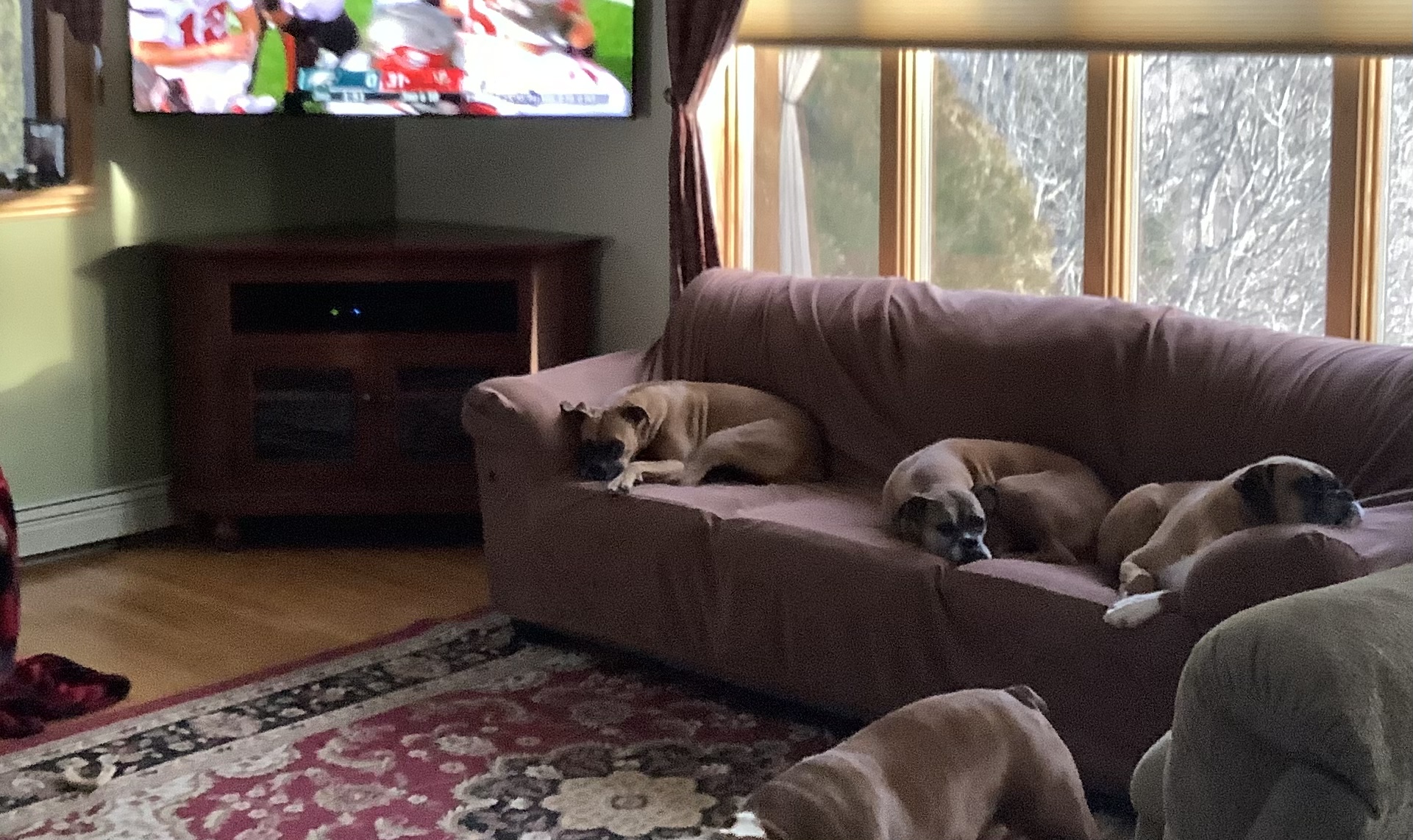

Any help would be appreciated. our tv placement is our best option in our living room. We had a Sonos Playbar and had a difficult time hearing dialogue. We we given a denon s660h. should I go with a passive sound bar and sub or should I buy a separate lcr set up if so suggestion would be great. We r in our mid 50 and really need to focus on hearing what the hell their saying when we watch tv/ movies. Ty in advance

You sure the tv has to be in the corner? I'd not want my tv in the corner. If anything using the avr with better speakers than a soundbar generally offers I think would be the best route....but then you have speaker placement options where? Whole floor plan might make more sense to us than the one pic....

Am I sure? Yes I’m sure I have a fireplace to the left of the window and a picture window to the right.. The room is part of an open concept. I can’t take a good pic cause it keeps telling me the file is to big.

Yeah I get room limitations for placement, we all have compromises :). However, where can you place speakers/sub? Placement is very important.

That’s why I think I’m gonna be stuck with a passive sound bar and a sub.
