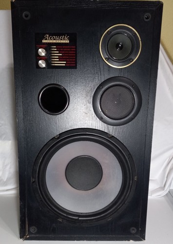

I would appreciate help in wiring diagram or how-to's. I'm getting an Onky TX 108, 4 Acoustic Monitor 3311 speakers, and a Proficient S8 subwoofer from my dad soon. I've been trying to research on how to wire 2 of the Monitor speakers and the S8 subwoofer to the rear output and maintain 8 ohms.

https://reverb.com/item/13801874-acoustic-series-3311-studio-monitor-oak I'm getting 4 of these, trying to get serial # for the subwoofer. I can wire it right and get 16 ohms, but kinda stuck as to 3rd pairing as to doing the sub parallel or series to drop ohms and still have minimum 8 ohms when running both a and b

They look like white van speakers (look that up). If you haven't gotten them I wouldn't. Why wire four in at all? It's just 2ch stereo signal in the first place.... (oh, and specify how you plan to wire, just to see what you have planned).

I've researched white van speakers. It's 4 channel amp with 2 front and 2 rear. The speakers my dad are giving me are loud enough to throw a concert so I know they aren't the "white vans" lol. On the back of the amp it says if only channel A, min 4 ohms. If A and B min is 8 ohms.
The way I am going to wire is 2 front 3 rear. I know there's a way to wire it in either parallel or series for rear to maintain 8 ohms minimum when using all channels but I'm having a hard time figuring that out. I think it's 2 parallel 1 serial in rear to maintain the 8... idk

No, it is a two channel amp (look at the manual). That's why when you add speakers you can't use as low of impedance for the speakers. White vans can be loud, just not particularly good. Would love to see a link to the manufacturer's info on them or a manual. If the speakers are decent, that sub isn't going to be a lot different than what they do. Parallel vs series wiring have tradeoffs....that you wouldn't need to worry about in a true 4ch amp.

I still think you'll likely simply get better sound with two good speakers in 2ch mode rather than doubling up on two sets of stereo speakers (somewhat fighting each other). Love to see some good specs (let alone measurements). No, it's not a quad amp, just a 2ch amp with A/B options (generally meant for listening in one room vs another). Beer budgets sometimes are enhanced by cutting off the beer (a big sacrifice I generally won't make). Good luck in any case!

Are these the speakers you have or are getting?
If so, they were made by the Speaker Factory of Gaithersburg MD USA.
They have apparently been in business since 1959.
Those speakers will be very old and I would guess from the 1960s or 1970s era. They are typical of many dreadful designs from that era. The formula was a 12" woofer, ported to give some sort of bass thump as a rule, a 5" "Squawker" mid range, which was typically a TV speaker and a cone tweeter which was usually of unmentionable quality. This speaker also follows the pattern of potentiometer controls to the mid and tweeter. This was done because the designer had not clue how to design a decent crossover, and left it to the user to balance the speakers as best he could by ear.
Those speakers may play loud, which may possibly be the only positive thing you could say about them, unless you are a neighbor.
Since impedance is usually anyone's guess and varies with frequency and is a curve, do not connect more than two of those speakers to your amp, or you will very likely destroy it.
Lastly, they will be nowhere near as good as your old KLH speakers if they came from the era when Harry Kloss was designing them.
