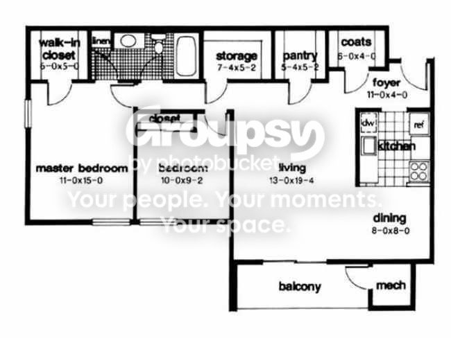

The "listening area" is a living room that connects to an open kitchen/dining room through two open sides with one wall running between the two rooms in the middle that doesn't seal the rooms off from one another that has a large couch against it (main seating area). I know this isn't ideal for listening purposes but it's where the girlfriend wants the couch, so I'm forced to make due. *I will attempt to embed, or attach, a picture of the room dimensions and layout with this post*
