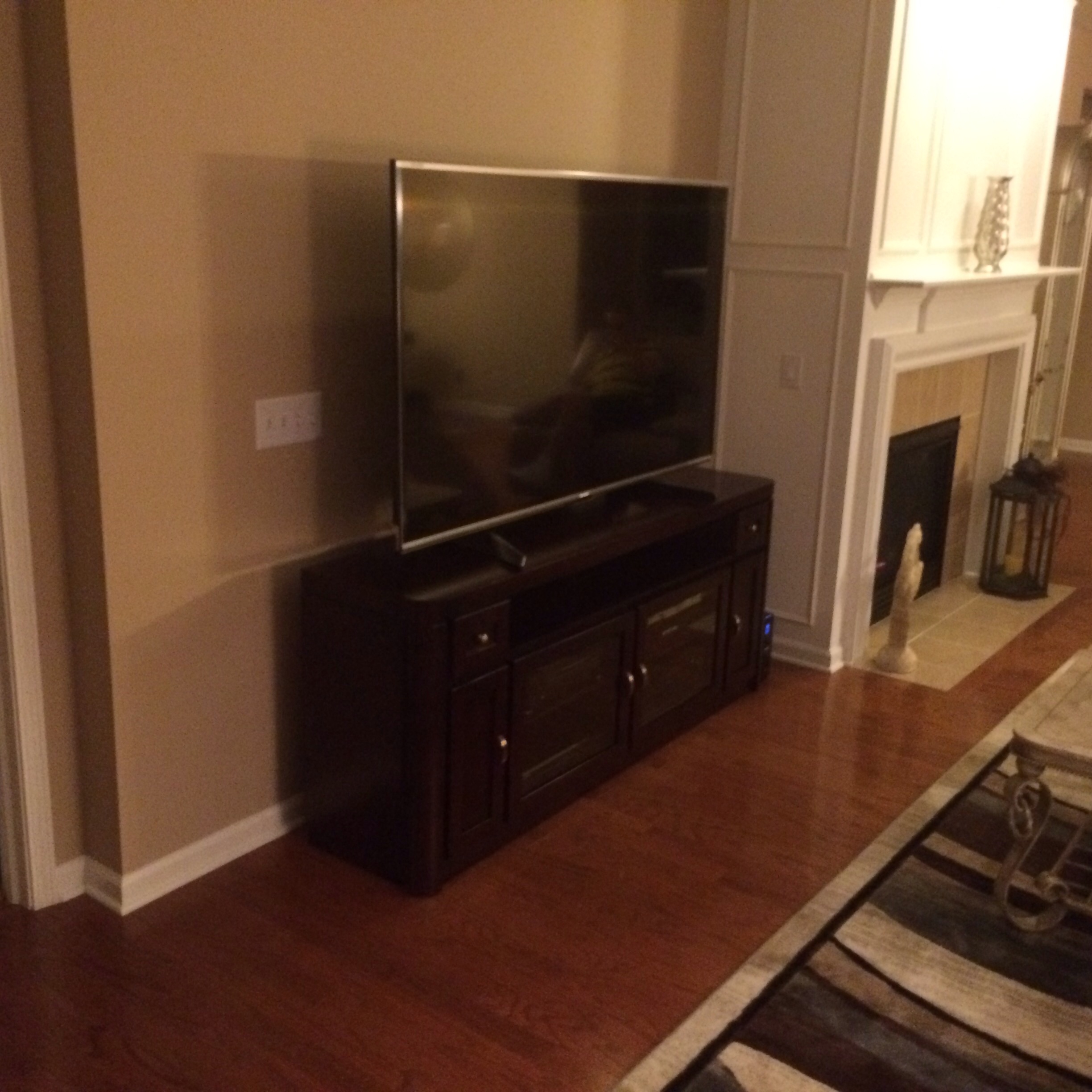

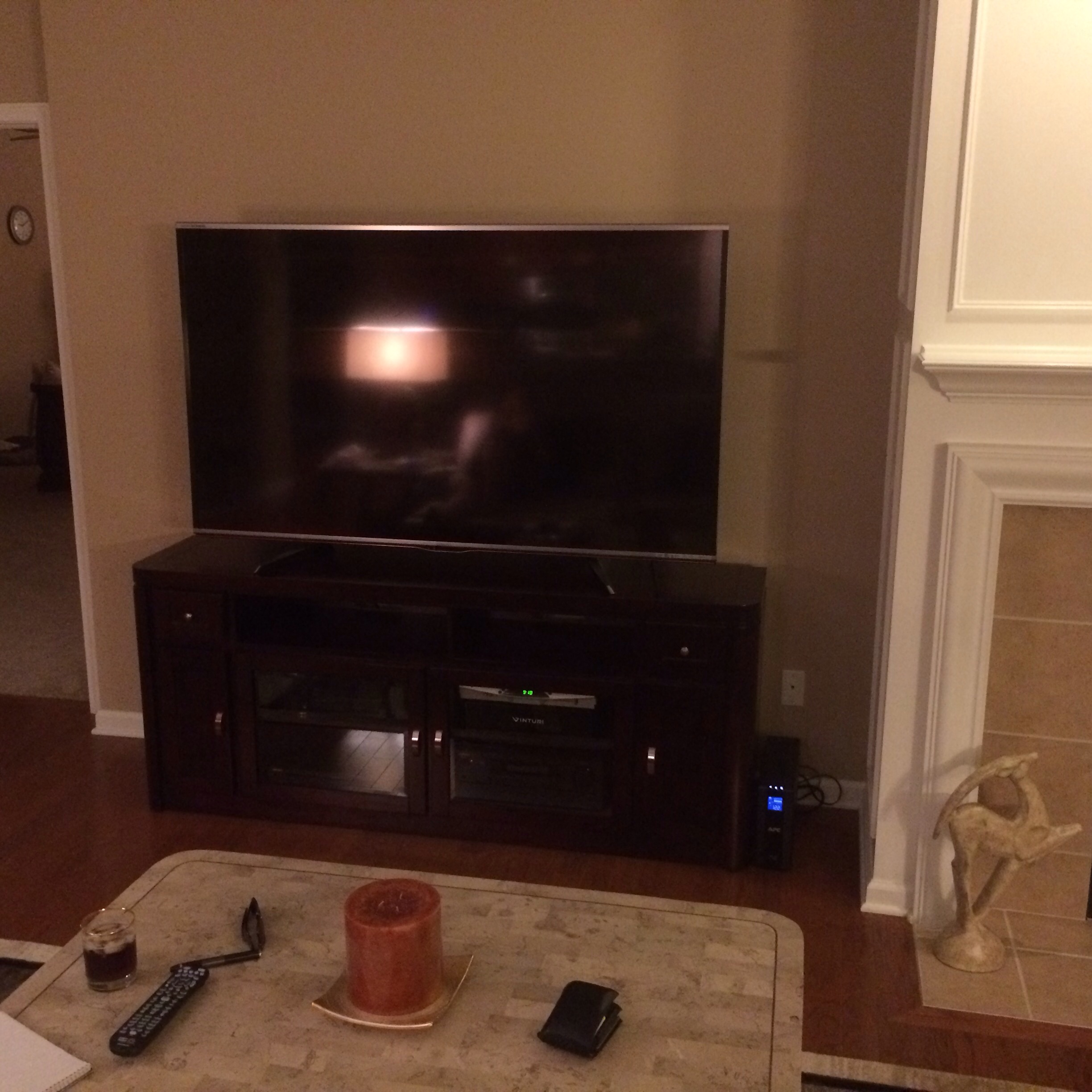

Was able to take some measurements tonight as well as a picture I'll post so you have a visual with what you've been helping on. Less space than I originally thought. 20 inches on one side and 11 inches on the other which could be leveled out a bit but the couch does not line straight up with the TV, it's to the right. From the wall to the end of the entertainment center is 20 inches. I am worried about the depth of the speakers too. With rear porting I assume I need to have 6 to 12 inches from the wall. Is this a true worry in rear ported speakers? Just think the 82's are going to be too big of a speaker for them. My mom looked a bit intimidated. The entertainment center has a middle brace bracket which causes the trouble for the center. At 7 1/2 inches depth it would be all the way to the edge. Let me know if you think there is a way to sneak a sub in that picture. I apologize if I wasted some of your time but not providing the available dimensions

Yeah, I'm with your mom, looking at that piece of wall, the Klipsch RF-82's would look totally out of place. And though I keep the grills off of my RF-82's, because the dual 8" woofers look cool, that would look wrong in that space.
Actually, I'm a little bit intimidated by the rounded corners of that cabinet and that whatever speaker you put to the left will physically encroach on the doorway (assuming you walk in front of the coffee table before turning into room to left of TV). I think it makes sense to select a more svelte speaker.
The obvious contradiction is you want to have solid bass from a non-imposing speaker. Is there a place behind the sofa that you could tuck a sub? I have been playing with using my rear speakers as fronts in stereo mode and if I cross at 60Hz, I cannot tell that the subs are behind me. The illusion that all sound is coming from the rear speakers is complete unless I put my head down by the sub!
If you can fit a sub behind sofa, it really opens up the options!

Actually they had a small chair to the left that I moved for the picture. Some not so big speakers will fit their great and not encroach. I even considered moving the TV cabinet up 5 inches to more in line with the fireplace if we needed a little more room for rear porting. It would still only allow 12-16in depending on speaker depth.
I should've took a better picture of the room. Behind the couch is a walkway. If I was standing behind the couch facing the TV, I'd be in the walkway and behind me to the left would be the kitchen and behind me to the right would be the dining room. To the left would be a kind of open sunroom to the back porch. It's a really open environment and the couch is kind of sitting in the middle of the room. No way for a sub to sit and wiring concerns.
I asked them before about wall speakers and kind of held my hand up for an example one but they were turned off by it. These are nice pictures though so I will revisit but not likely.
