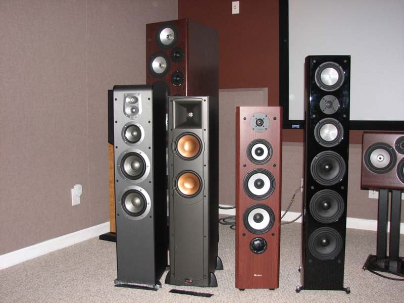

The M60v3 we used in our shootout had no HPF on the mid and would trip the impedance circuit of a Marantz PM-11S2 at high listening levels with bass intense music. The impedance minima near DC was lower than 5 ohms from my measurements as a result of paralleling the woofers and mid.
It's possible Axiom changed this with their latest design which we haven't tested.
