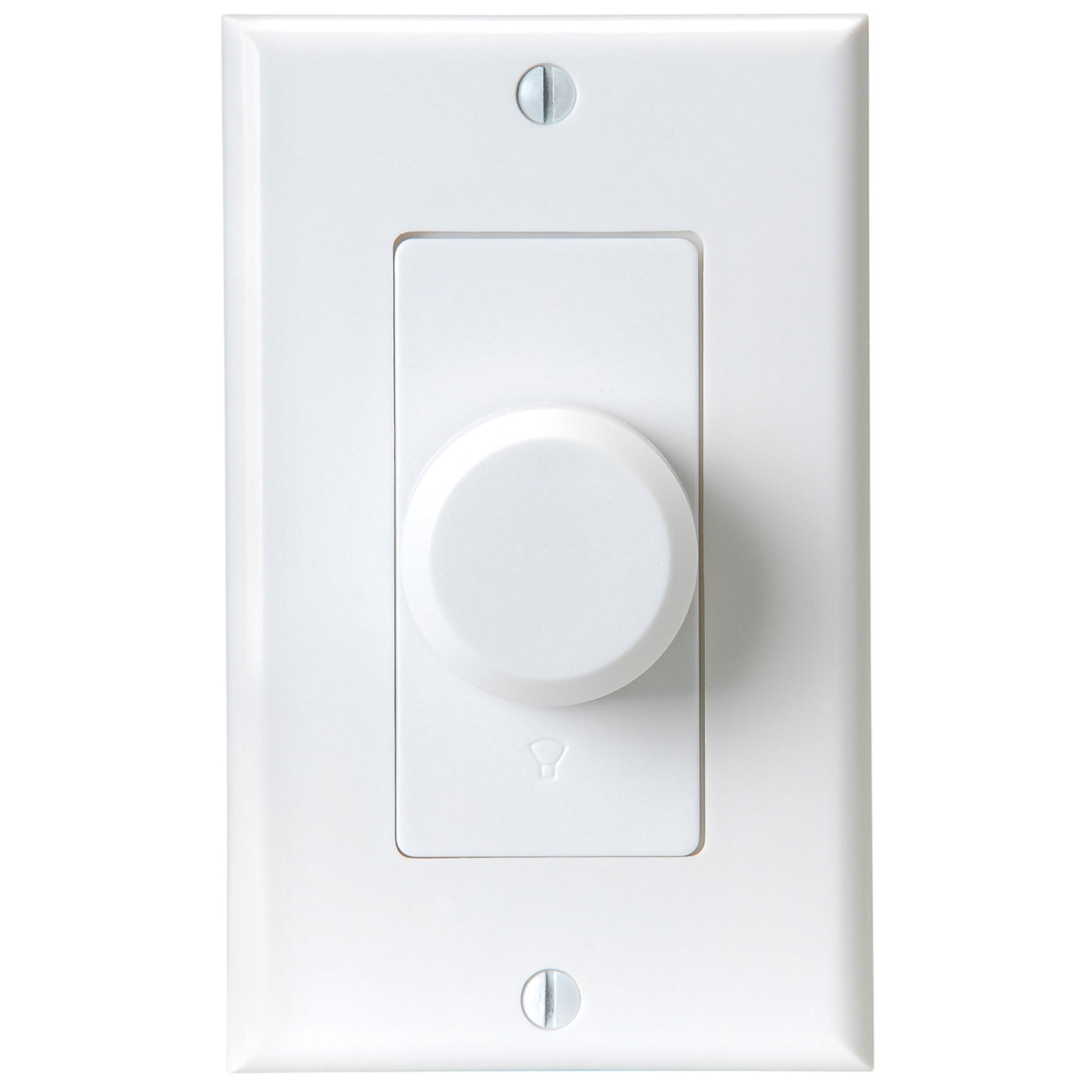

Did they wire volume controls? What's your budget

What do you mean with wire volume controls. Forgive me for my lack of knowledge but i have no idea about watts and things like that. The speakers i got still in the box unopened. they're the polk rc 80i two pairs.

Did you have the wire run when you remodeled? If so did they wire in volume controls for each area? What's your budget
