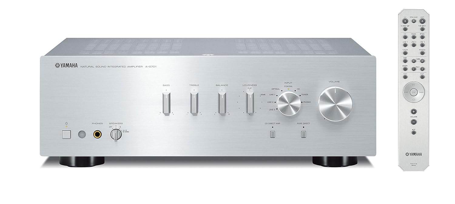

Yamaha A-S700 or higher:
https://www.amazon.com/Yamaha-S701SL-Natural-Integrated-Amplifier/dp/B00MXUCMXS/ref=sr_1_1?s=electronics&ie=UTF8&qid=1507764291&sr=1-1&keywords=Yamaha+A-s701
(also available in black)

Interestingly, both of the receivers above have jumpers between the "pre out" and the "main in" so you can isolate the pre and the power amp. This could come in handy should you ever decide you want a separate power amp or in the advent of a failure of one section, you can continue using the other (depending of course on where the failure occurred). I don't expect failure, but given your Sansui just crapped out on you, this might appeal to you.

The Outlaw RR2160 receiver and Yamaha A-S700 integrated are very close. The Yamaha Receiver is rated the same, but I have looked under the hood and the A-S700 is a step above the R-S700.
But all of them produce more than your Sansui (which was 60 WPC into 8 Ohms), so should have an easy time with the Mirage (which look to be a nice speaker)!
