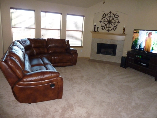

I am new to everything audio. I am setting up a budget ($1000 roughly) 5.1 system. People in another thread convinced me to increase my budget for the sub. I was thinking about the Dayton 1200, but those may not sound great with the 3 HVL-1s I plan on purchasing. I am looking to spend no more than $500 on a sub.
I will mainly be using this to watch blu-rays and TV.

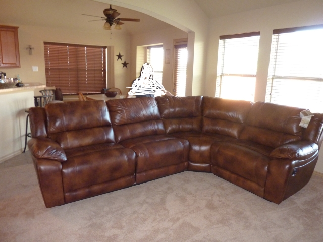

Please look at the pic of my area. Here are my thoughts (open to suggestions of course)
2-12" Daytons
SVS 1000 (would the 10" fill my area though)?
Rhythmik LV12R ($569 is slightly over what I'd want to spend but if it's the best I will take it)
Hsu STF-2
From the TV to the sofa it's about 12 feet, and from the back of the sofa to the back wall there is about 13 feet (~25 feet total). I'm not worried about the sub filling the area in behind the sofa. Also, I want something that will fill the listening area (couch & forward) as best as possible without "overpowering" the HVL-1s. Please don't recommend a DIY.

Thank you very much, Kurt. I keep going up and up on my price. Before you know it I'll be at $1000. I'd rather try the $600 at least first since it is risk-free. Who knows, my ears may fall in love with it haha.

I actually did try the HVL-1's with the Dayton sub. If you're interested you can read about it at this link (scroll down toward the end of the Impressions section for what my assessment of that pairing was).
Maverick's idea is a good one; the XS15 would definitely be a better match, and with a room that's over 4600 ft^3 you're going to need more than the SUB-1200 can provide.

Nice to hear from you, Jim. I actually read that review before my purchase. After many suggested the Dayton sub at first, I did some research and ran into your review. It seemed like you thought although the HVL1s and the Dayton sub are both "budget," the HVL1s in a way sounded better than what the Dayton sub did. After reading that I decided I will look for another sub.

I'm glad my review proved helpful to you. It's always nice to hear that one of my evals was beneficial to someone.
The XS15 is the better value and they should sound very close until you start cranking it up.
So...see how hard you are pushing the XS15's.
I'm glad you spotted the PSA sale and upped your budget!
BTW, don't read the review of the XS15se I linked above if you are planning to buy the XS15

Thanks for the info. Glad I saw the sale too!
I didn't...sorry...I knew it was out of my budget by far haha.
