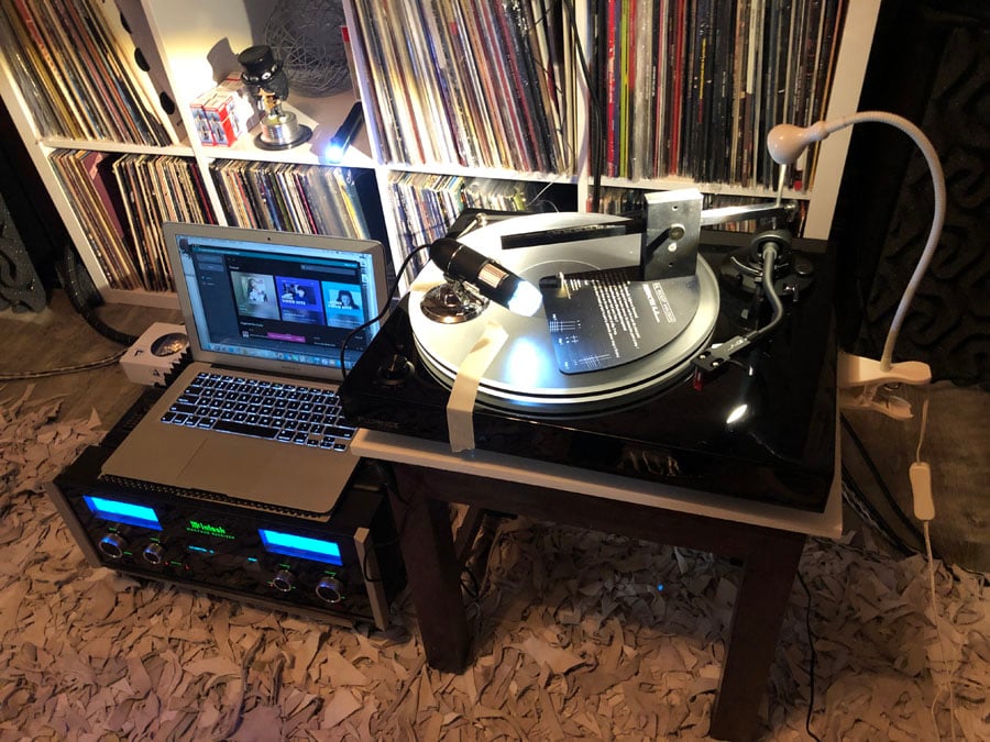

Just did. Interesting. I find the anti-skate setup a bit...chintzy?
I did not watch the video....what is the anti-skate setup you are referring to? Is it the little weight and the fishing line?
If that is it, I believe that @TLS Guy told me years ago that this is one of the preferred anti-skate devices (I had the same comments on it as you).
Yes, that is the best anti skate device.
