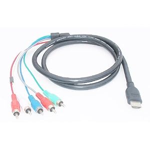

I have set up my Pioneer VSX 919 receiver with both Foxtel and Blu Ray input via HDMI. With this set up it only allows me to output via video via hdmi. Unfortunately, I have an old style TV with only component and scart inputs.
Am I somehow able to convert HDMI to component video. Can I just buy a cable that has an hdmi plug at one end and component video at the other, or is it more complicated than that? Many thanks for any assistance, it is very much appreciated !!

It is a lot more complicated than that. Component is analog and HDMI is digital.
So first you would have to convert, but it is an illegal conversion. HDMI has built in DRM via HDCP codes to prevent piracy. So it it is a two way communication for continuous handshakes.
If you want to use HDMI you will have to buy a new TV.
SCART can not pass an HD signal.
If your receiver will not down convert to component, and a lot don't, then you will have to hook everything up via component.

http://www.amazon.com/Component-video-YPbPr-Converter-Up-scale/dp/B0016SN49Y/ref=sr_1_3?ie=UTF8&s=electronics&qid=1280673106&sr=8-3
http://www.amazon.com/Component-Video-Stereo-Audio-Cable/dp/B001IUQB2W/ref=sr_1_1?ie=UTF8&s=electronics&qid=1280673106&sr=8-1

You could use a HDFury adapter, they are fully HDCP compatible and provide component outputs. Their quite pricey though, £199.99 for the newest and best version (HDFury3). Don't bother with the original one though as it only has DVI.
http://dme.ghost2.net/hdfury/

Just hook up your Foxtel and BD player with component video connections. Until you get a new TV this is by far the least troublesome and highest quality means to get great video.
Depending on the device, you may be able to still send audio out via HDMI if lossless audio is something you are able to get with that receiver.
