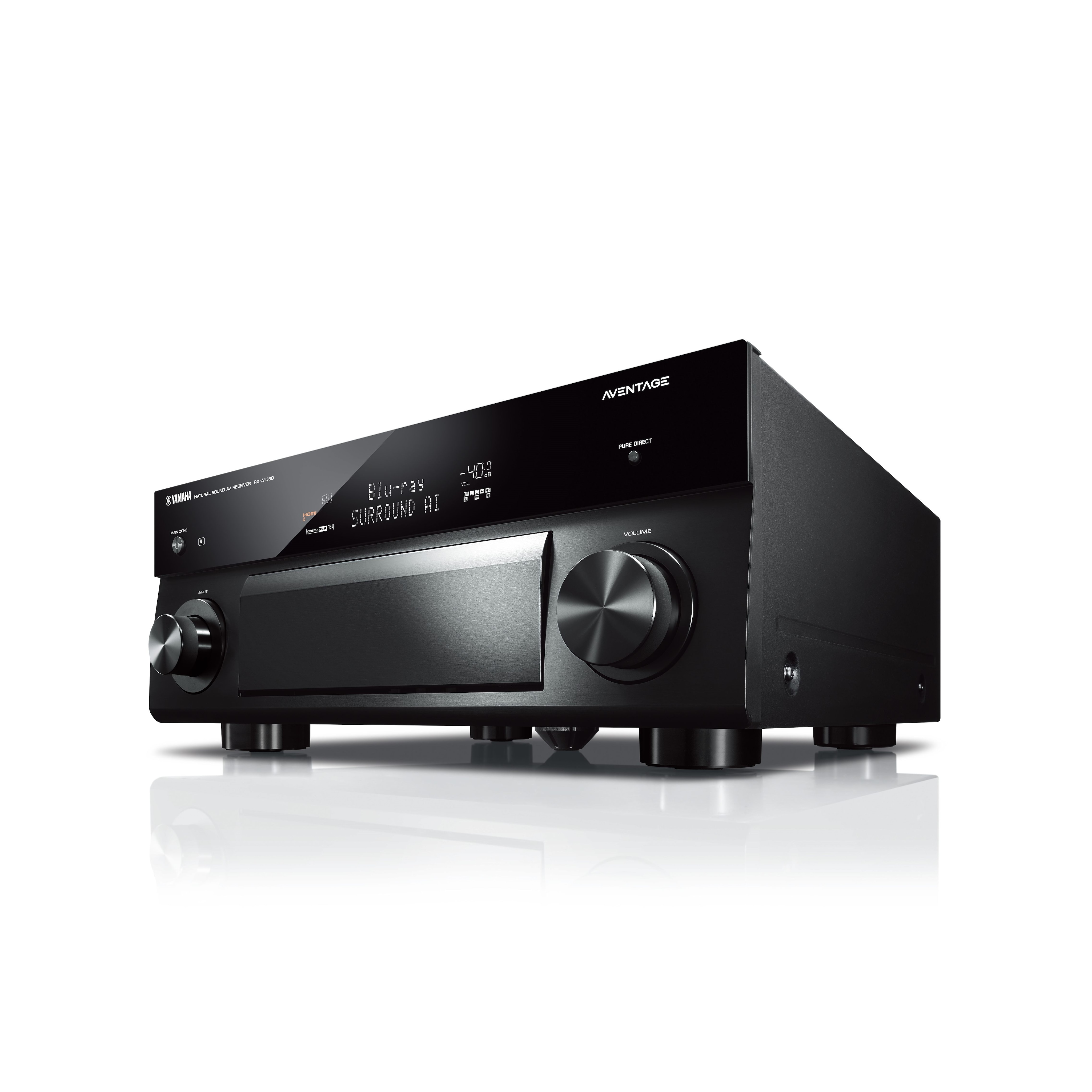

I want to take advantage of my ARC connection from my TV to my Yamaha Reciever ! Problem is I have a few Monitors. Living room, garage, bed room and my office. So I come out of the reciever HDMI out (ARC) to an HDMI splitter that connects my other monitors. Why do they not put two monitor HDMI outs on recievers?? so if I just go strait with one HDMI cable to use all things ARC than how do I run my other monitors???

So what should I do ? I have a Yamaha Reciever and have always had one. Is there a solution?

Fine I explained the situation perfectly so just tell me what AVR has more than one monitor out!
My older Denon 4520 has two hdmi outputs. Not that unusual or do you mean something else?
