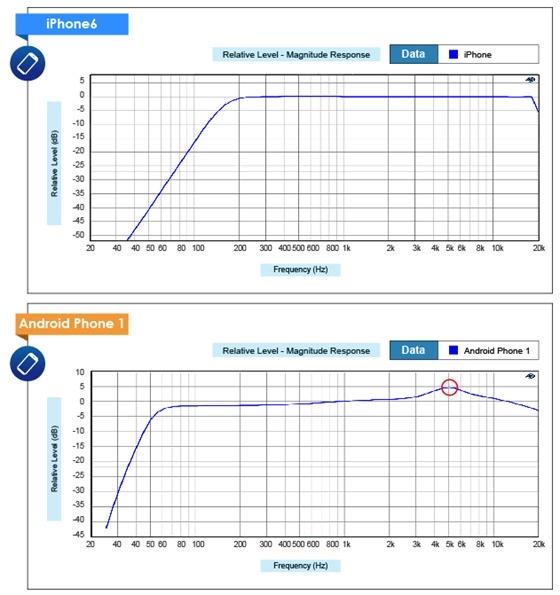

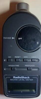

If you’re in super budget mode, try something like this cheap old solid spl meter.
Phone mics just can’t reliably so low frequency stuff. The mics roll off too early to be useful.
You can see in the graph the frequency response of two totally different phones. If the app developer hasn’t programmed the roll off into the app, it will be even more useless.

Well REW is easy enuf to get, and think there are spl meters it can work with....
YeH I think my ol RS meter can. Before hdmi I made some cables to measure with. Single rca to mic input on a pc tower. It sucked. Had to run 60’ of speaker cable from my av rack in the LR to my bedroom pc cause I was too lazy to pull the pc out into the LR lmao. Also I was using a BFD to EQ my subs. Good times…
