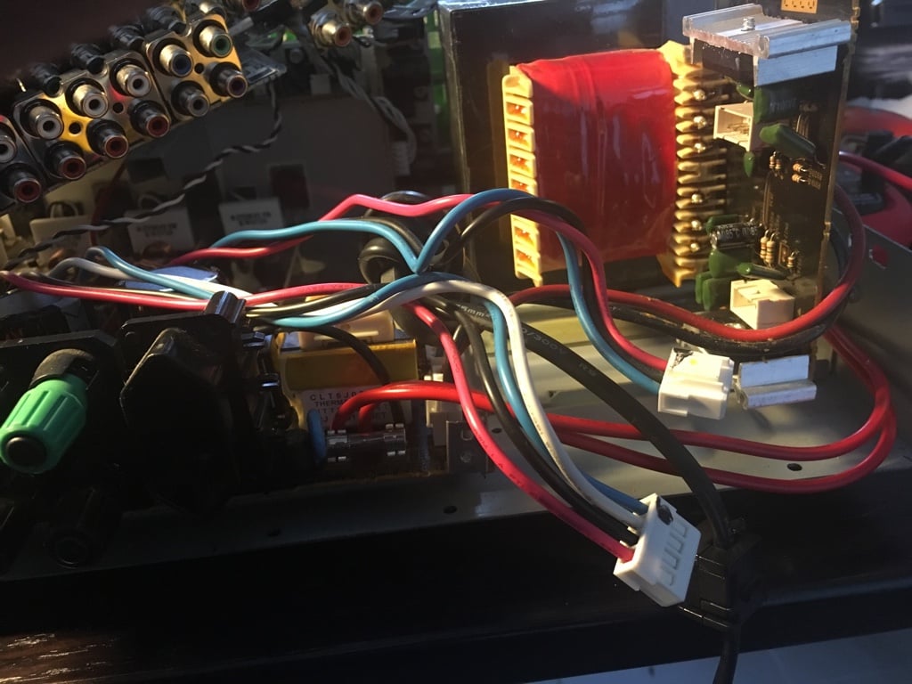

Hello everyone,
Last week I was watching a movie, and the amplifier switched off (I heard the relay open).
Now, when I hook the amplifier in the wall, it stays on standby mode (amber color).
When I push the button to turn it on, the light stays blue for about 10 seconds, and goes to standby mode again. The relay doesn't close, when I push the button. The front LCD doesn't show anything during the 10 seconds (ON mode).
I already looked inside, and made some tests.
The fuse is OK.
I do not see any blown component.
I already measured the 12V transform and looks OK.
The main transformer have a small resistance, so I supposed the coil is OK.
I measured the relay coil resistance, and have the right value.
Any thought's?
The manual service for the HK AVR 147 is available here.
Any help will be welcome! :)

I disconnected the power cords that connects to the power amps and now the LED stays blue, but I don't hear the relay close.
So now you know one of the power amps is bad.
