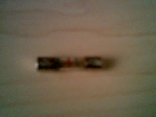

Heres a pic of the fuse....
You can't really see it in this picture, but the wire in the glass is broken.

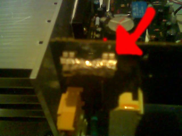

The pic of your fuse sure looks like tinfoil in the fuse holder... that would be a very very bad idea.
If I am understanding correctly now - the fuse did not blow again, but still the sub makes no sound?? Can you verify the status of the replacement fuse with an ohmmeter?

Ha, bandit, I didn't think of that. I have seen fuses that are blown that don't appear to be. If you don't own a multimeter or ohm meter, you could just put the fuse in another circuit. You could test it using your speaker wire and just place it in line somewhere. If you don't get any sound the fuse is bad, if you do, then it is fine. Be sure to do this at a low volume, and do not run this test for very long, just long enough to verify the fuse works. The fuse may present more resistance and strain an amp if used for extended periods of time. (I am not positive that there would be resistance, just want you to make necessary precautions when testing)
