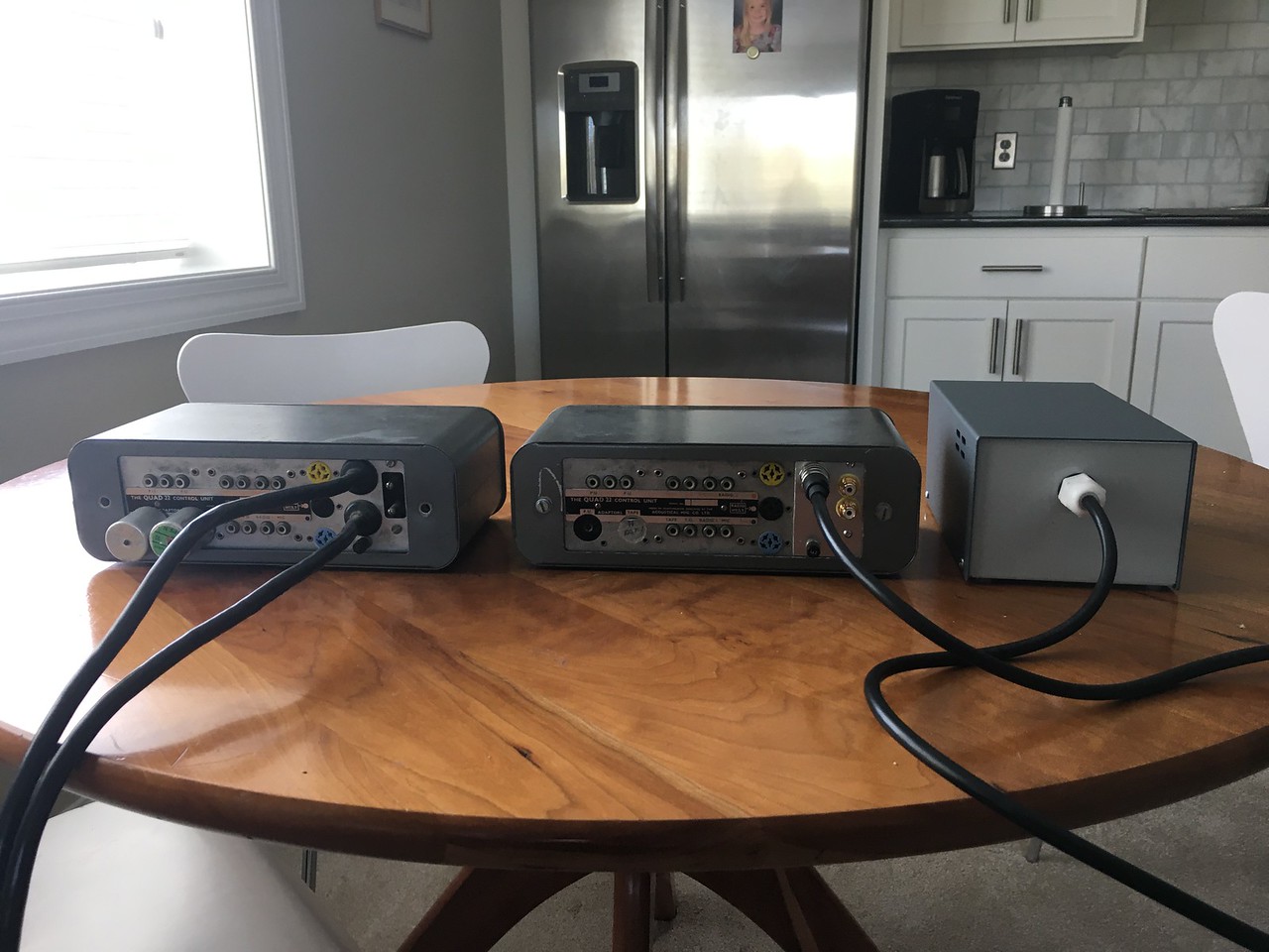

Above is the unit next to my original Quad 22. It is the one in the middle. It is next to its power supply. The original on the left still has the LP Eq can and the line tape can.
These have been dispensed with and the standard LP MM RIAA equalization is now internal. The tape input has been converted to a standard line input.

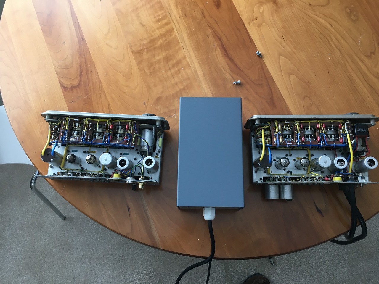

Top view case removed.
