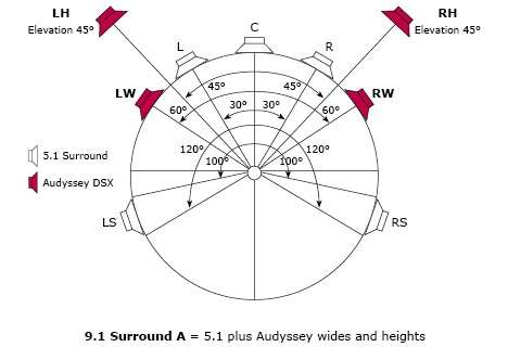

As high up on the wall when following the 45 degree angle from main listening position. Like this,
I have assumed Audessy DSX type speaker placement. If you are not using Audessy processing, follow the directions in the User Manual for your receiver/pre-pro.

Yes I got the 45 degree angle thing but was sure if I needed to move my L & R in narrower to get the Heights to be outside them, there will only be about 1' difference in width with my current setup and that is putting them in the top corners of the wall
Yes Audessy is in use (who would live with out it :D I will never since I have it!)

On the subject of moving the Mains, 1" will not be discernable :).
If you do not have the Wides, try those first. Per the Audessy website, Wides before Heights. For the wides timber matching will be critical to ensure you have a good front sound stage.
