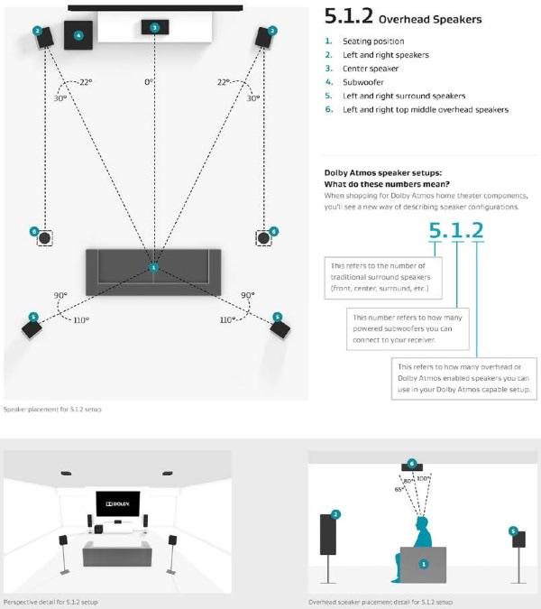

Pretty sure FH position does not lend to more accurate overhead sound. It just can’t. That article was cute, but doesn’t even mention the Dolby Atmos guides and following the angles, which is what Atmos speaker placement is actually about.
Top front is usually recommended for DA in a 5/7.x.2 system.
