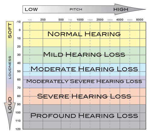

If your hearing is at all normal, you can hear 20 Hz. Age-related or noise-induced hearing loss attacks upper frequency sensitivity thresholds. As far as I know, low frequency hearing isn't typically lost, unless you are what is termed 'profoundly deaf' (see figure 1). Anyway, you will have to buy a bunch of PB13 Ultras to make sure. Tell your significant other that the expense is justified because it is in the interest of health concerns, as low frequency hearing loss would be a health issue. ;)
Figure 1!

I'm not a subwoofer hobbyist but I appreciate the sentiment. My sub will reproduce 20 hz without a problem. But it is 9 db down at that frequency. I have 20 hz. test tones. I can feel them but I can't hear them. What I hear is the subwoofer driver fluttering, not the tone.
