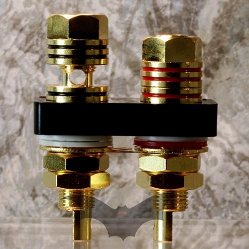

If they look something like this, I would imagine that the plate could be removed from the floor and a plastic spacer added to the rear, just enough to allow the cap to be screwed on from the top. If the cap is still too tall, part of the cap could be cut off, but the post needs to stay because that's where the thread is.
How are they attached to the floor- with a wall plate?

There are plenty of products that can flush mount, similar to what Teetertotter mentioned, but installing them in the floor in the first place sounds really odd. What was the reason for that?

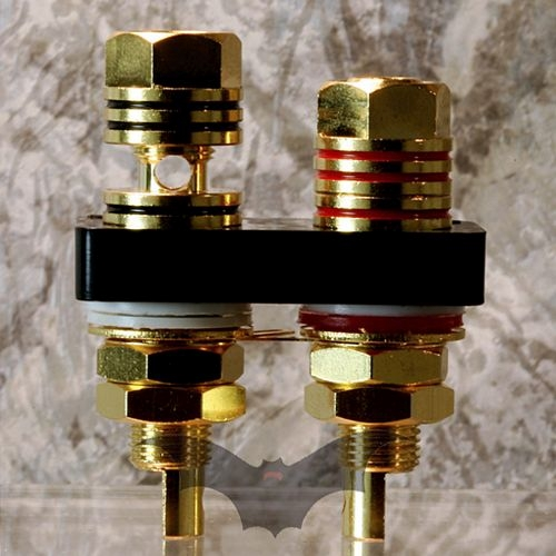

Here is another example one:
Standard recessed gang box, into which you would install plates with the binding posts.
yes and yes
That also could work. Need to show these to my AV guy and see what he says

The same part can be used, but the installer needs to know about them and have a bit of imagination. The fact that he actually said "... there is absolutely NO product that can be installed such that the plugs would be flush with the floor as I want" worries me- low profile terminals have been available for several decades.
The ones in the sub are called 'panel-mount' and could easily be fitted to a wall plate or even a flat plate of metal. The thing about Neutrik SpeakOn plugs is their size- a connector isn't actually needed.
