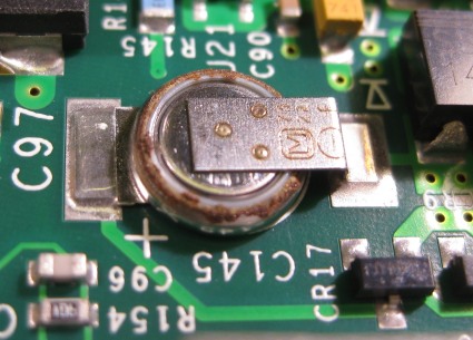

You should have a look at this. This Martin guy is very respected on the web along with Dave Jones from EEVblog.
T4D #88 - Fluke multimeters with leaking / corroded surface mount supercap - 189, 287, 289 - YouTube.
Here's an imageView attachment 13069
Fluke have acknowledged the problem and are working with the component supplier. They say they will fix/replace these meters if these caps cause problems. There is a fine line between where it is a cap or a battery. I would call it a battery, which is probably why it corrodes. It is there to power the circuit that keeps date and time. Why on Earth you need that function in a meter eludes me!

The board will have a Revision Number etched under the solder mask.
You could ask what Rev # the leaking cap/board is and check yours to see if it's a later Rev #.
It may also be a bad choice using that type of cap in that application.
Could be it doesn't like the solder process they're using?

I agree with TLS. They've got a hybrid, so to speak, cap/rechargeable battery there.
IMHO they shouldn't permanently solder it to the board, since the life is 4 to 5 years.

It is an issue. I did some research, and CDE claims an expected life of just 2.8 years if humidity levels are kept below 50%! Why would Fluke chose such a component to put in a meter with a 10 year warranty, and they say this is a non-issue? Every tech I spoke with at Fluke claims they have never seen the issue come back to them. Ya ok. They need to stand up, and admit they made a mistake! If someone here owns this meter I'm willing to bet if they open it, they with find a corroded super cap. Sending it back for an Agilent U1272A I think. Just know I will have the same issue given time. I think it's pretty obvious. Would probably keep it if Fluke just would admit it's a problem.

That is the issue. That cap/battery takes a 150 milli amp charge for 10 min after meter switch on.
The problem is that the chemicals inside are reacting with the metal case.
The solution is to remove that circuit. I still fail to understand why it needs to show time and date! If someone said he wanted that feature on a multimeter, I would say: -"Don't you have a watch or a cell phone?"
