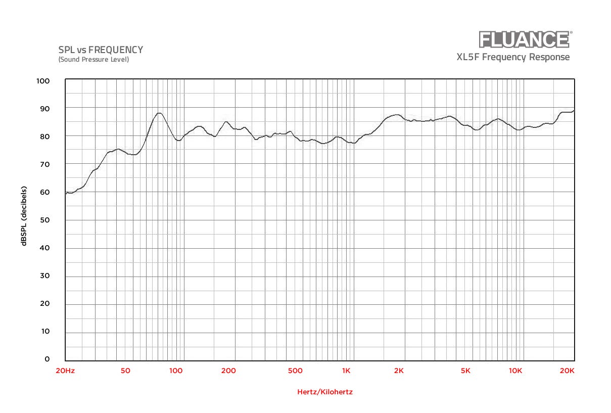

The XL5F and the XL7F are both towers -- nearly the same size physically, both 3-way systems. And the frequency response chart for the XL5F as presented by Fluance isn't as flat as your top chart, but isn't as jagged or discontinuous as your bottom chart either. Is your XL7F chart from before Fluance fixed the crossover problem in that model?
What frequency response charts don't show you is how far the speakers go into fine detail. What I've realized comparing the XL5F's to my Klipsch RB-51 II's is that although the Klipsches have beautiful tone, they hollow out the sounds compared to the Fluances. That is, they leave out a lot of the subtleties of the harmonics to present a cleaner, in some ways prettier tone -- but one without the fuller presence of the voice or instrument that the Fluances present.
The frequency response chart for the XL7F comes from the NRC of Canada via SoundStage! http://www.soundstagenetwork.com/index.php?option=com_content&view=article&id=835:nrc-measurements-fluance-xl7f-loudspeakers&catid=77:loudspeaker-measurements
The Fluance model that had the (hopefully fixed) crossover problem was the Signature Series tower. After seeing that and the 3rd party measurement of the XL7F, it's hard to have confidence in any of their speakers.

I'm sorry Whit, but I think you can understand why we are skeptical. Even the FR published by Fluance shows a 10dB range of SPL in the critical mid-range frequencies:
If we take the factory curve at face value, then the mids actually look excellent. It's the higher frequencies that are ramped up, and I would expect the speaker to sound quite bright. On another issue, you can't really compare my plot for the AAM2 with the NRC plots in that I don't show any information below 200 Hz, which is the lower limit for quasi-anechoic measurements in a normal room. Below that point the very short sampling windows used in quasi-anechoic measurements can't capture enough of the longer bass wave lengths to resolve a frequency response plot. I would love to have one of my speakers measured by NRC even if it were only for my own edification. I remember seeing a post that discussed how someone like me might get that done, but I can't remember where.
What do you consider the midrange? I'll agree the plot is smooth, but I would have thought the 10 dB increase between 1kHz and ~1.8kHz to be a problem.
