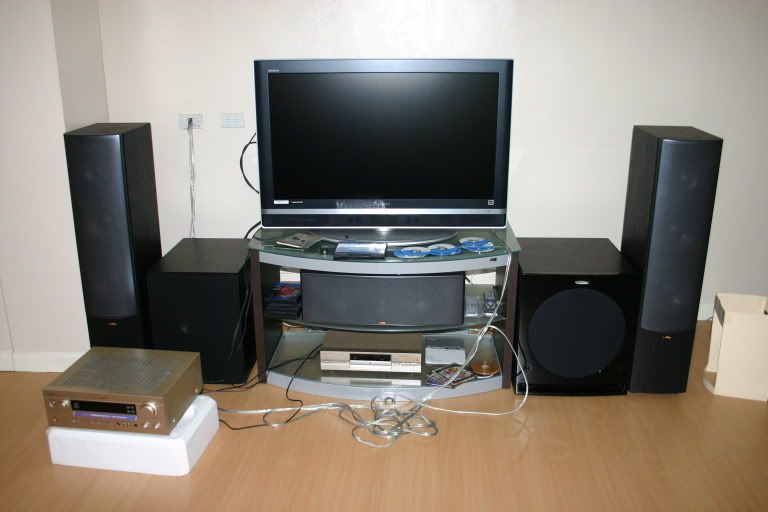

ok, I did a little arranging ... now everywhere but where I sit has good strong bass (i.e. corners of the room, just in front of the tv, standing up)
by ear, they seem to be dips.
oh, I already tried using just 1 sub (both of them in their own)
anyway, what to do if the sub and seating locations are fixed?
will room treatment help? what kind? (am only interested in treatment that will help improve bass)

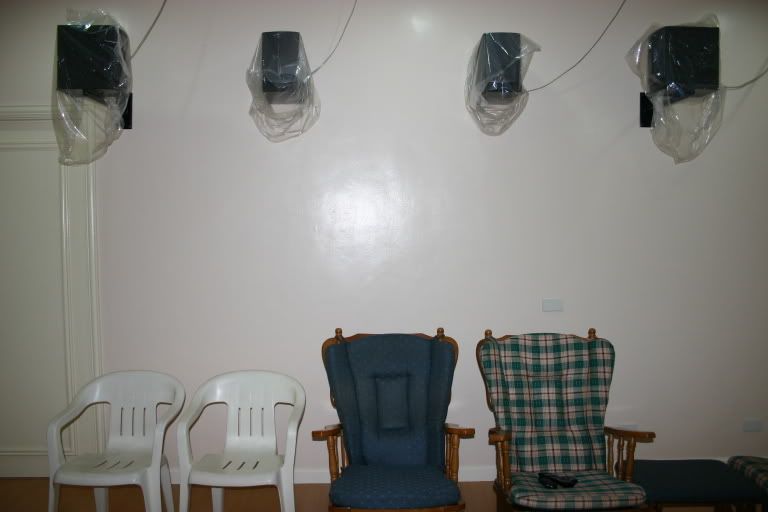

Particularly with not one soft surface (other than the seat cushion) shown in the room.

nope, totally different setup. it WAS the same room, but I renovated it in time for my marriage this year.
my previous sub was a JBL HTIB sub (10" 150w) it didn't have any kick in the chest or pant flapping powers. but after I removed my carpet, even my PC altec lansing sub can boom the room. (boomy of course)

The very first thing I would do is plot the frequency response at exactly where you sit, since you have no options left. Check each sub by itself, write it down, then both together and see what you have.
http://snapbug.tripod.com/
This has instructions how to and a link to a Word document, free, to plot it. You can use the second chart where it has corrected response for the second sub so you can see. The third chart would be both subs running. It also accounts for the Radio Shack FR inaccuracies.
You need a CD with low frequency sine waves to excite the room modes, from 10 Hz to at least the crossover frequency, hopefully in 1 cycle increments. Need an RS Spl meter, and a stand such as a camera stand to hold the meter.
This will tell you where and how bad the fr stands. Right now, you only know it is bad; that is telling nothing.
I would also recommend that Behringer DSP 1124; in is $100 in th eUS, not sure what it would be there. Maybe that poster from Canada, can ship one as it only costs $100CND :D It has 12 frequencies you can adjust in each channel.
I doubt room treatment will fix a 20+ dB spl variation and you will be lucky if that is all you have.

Mike, if that is where you have your subs positioned then that is more likely one of your problems. Up front is possibly the worst place you could have them. That spot has never worked well for any room I have ever tried.
Since you have 2 subs you really need to place one in back and one in front. preferably both in center but if that won't work then try oposing corners. That is how I have my two and I have good response from every seat in the room. Read all of this article and look at the charts in the back. http://www.audioholics.com/techtips/setup/loudspeakers/SubwooferplacementP1.php

jeff, I have piping in the floor just for the sub cable that goes from front to back. but will have to put in the wire (its empty) I will have to wait for the equipment to arrive before I start moving stuff. My back almost gave out moving those ... alone! :)
when you say opposing corners, do you mean, FRONT LEFT and REAR RIGHT? or FL and RL?
Yes, exactly or fc rc if you can do it. Mine are FL RR
