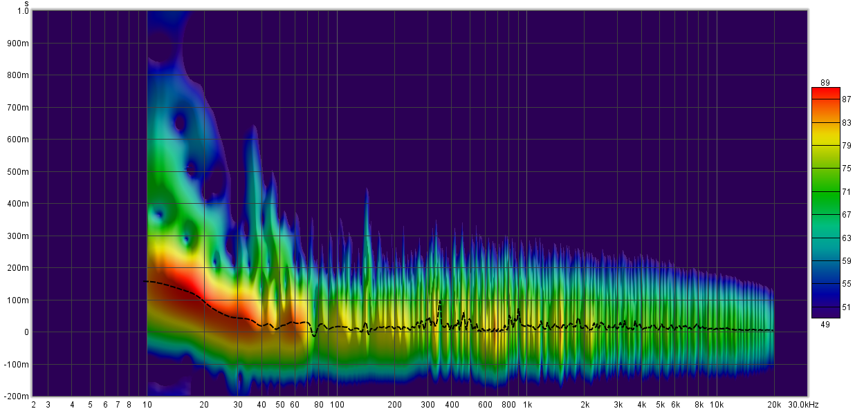

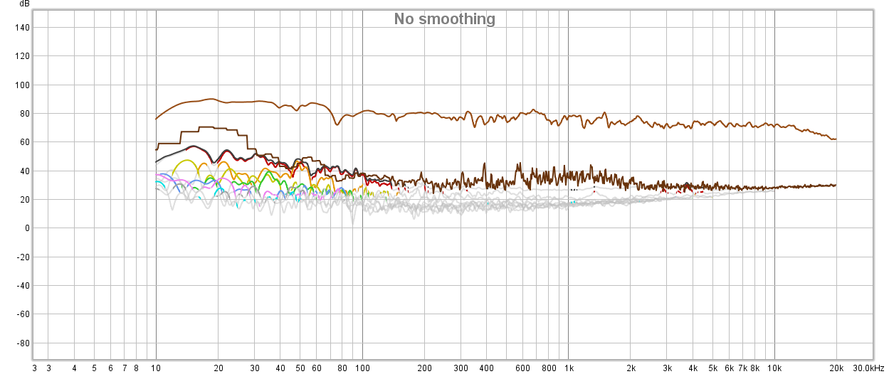

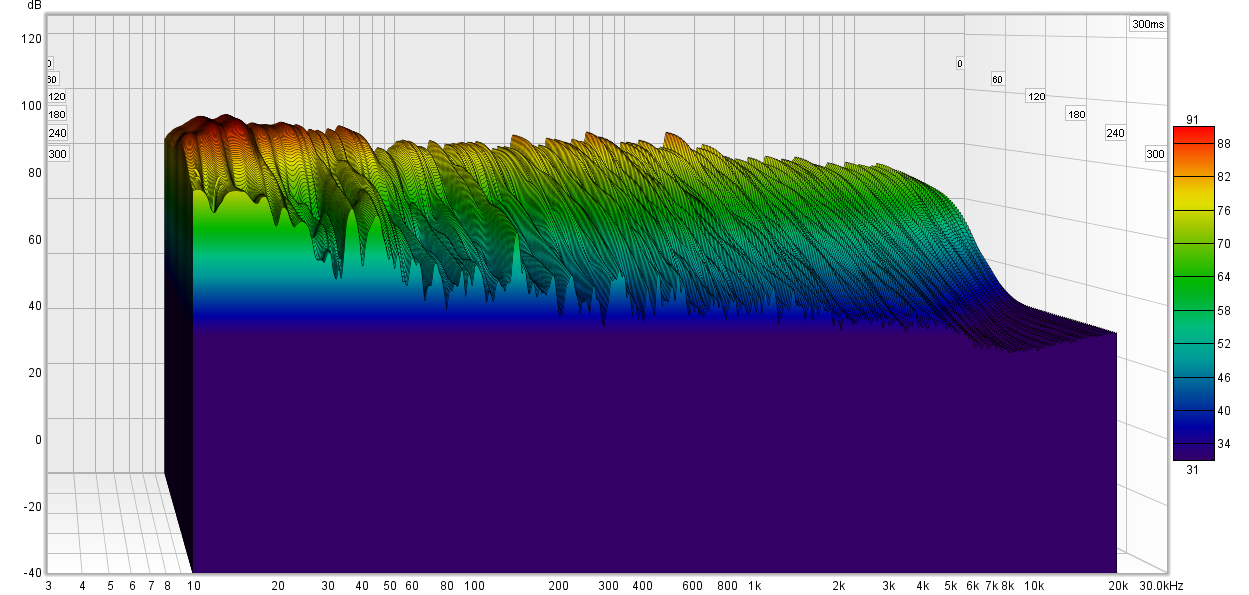

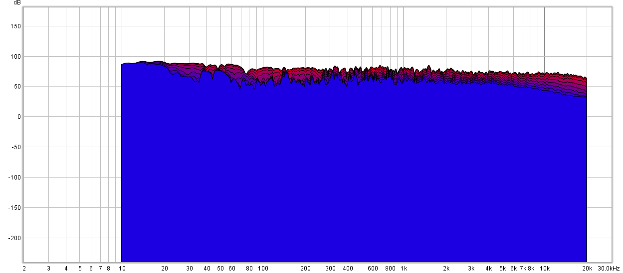

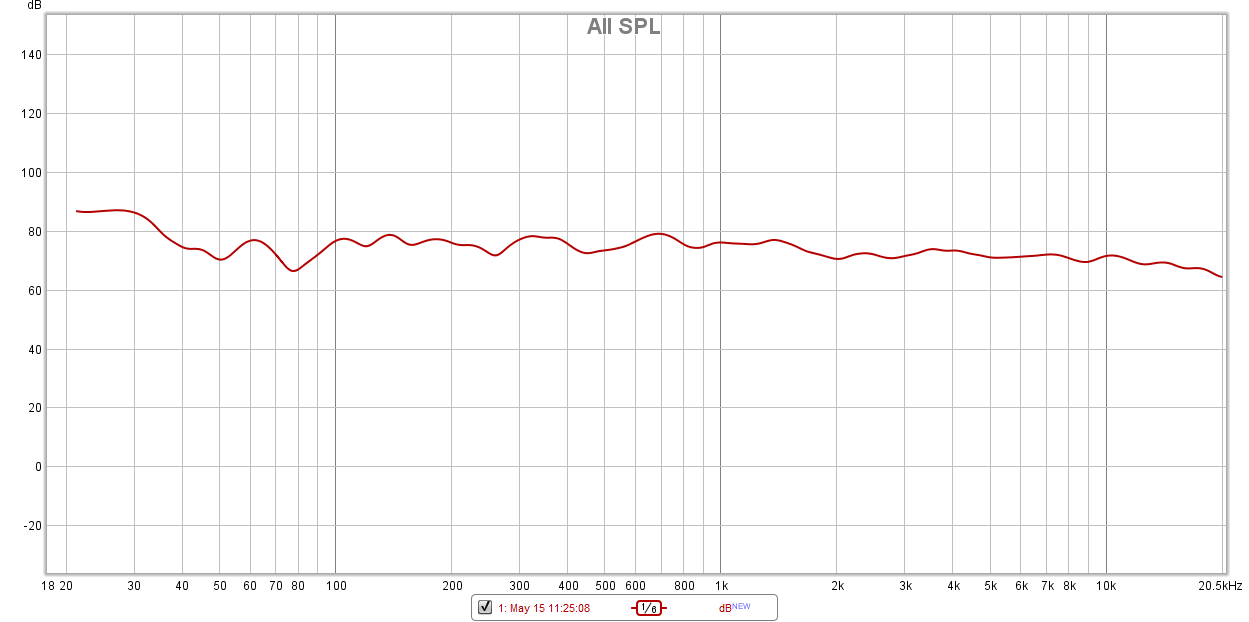

Pretty excited to get my first sweep, even though I barely know what I’m doing.
My config is in my sig. Measured on mic stand from MLP, set Audyssey to OFF, connected UMIK-1, mirrored laptop to Denon via HDMI, and this is what I got. Anything interesting jump out for those who know what this all means?

A lot of the stuff you posted isn't very meaningful, sorry to say. Those distortion levels are very high, but I think it is a measurement problem and not the actual performance of your system. You should just post the basic frequency response graph at your listening position. Make sure it only has a 50dB window on the Y-axis.

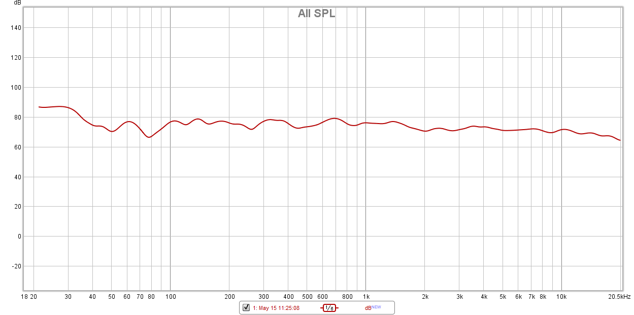

Is this what you're referring to?

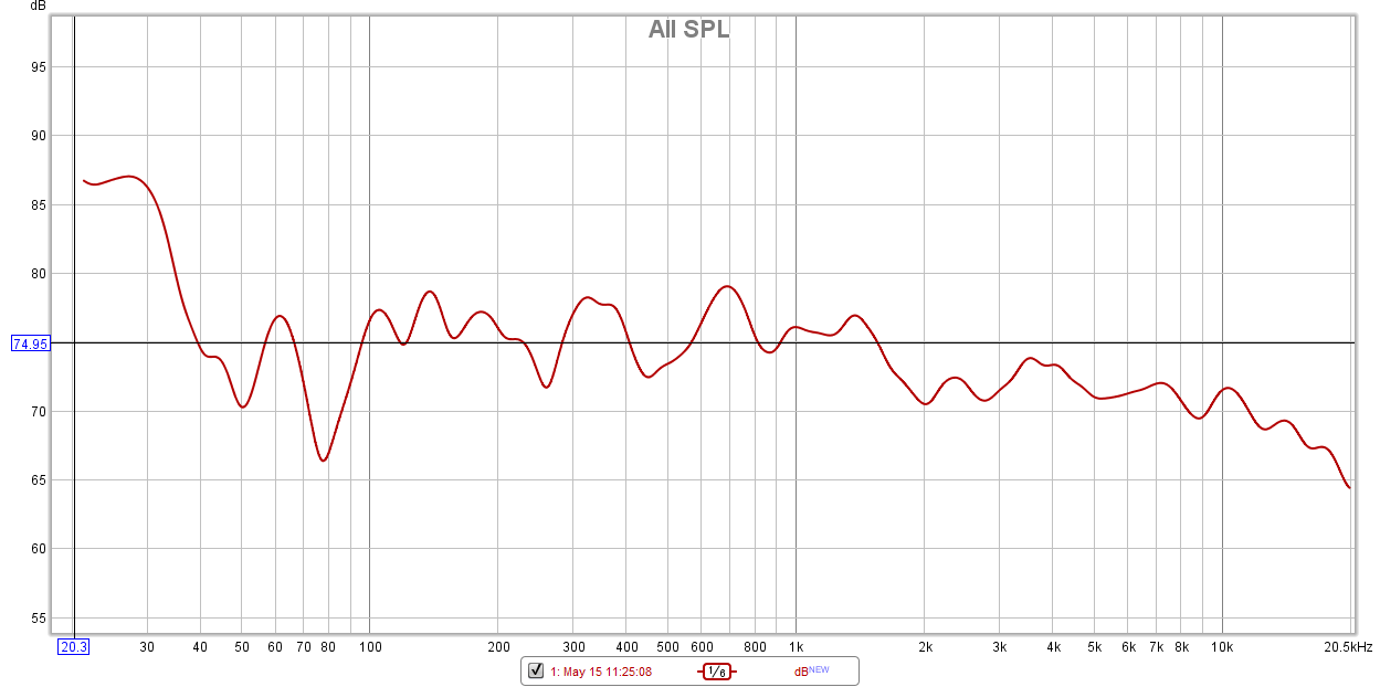

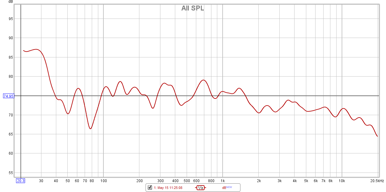

Yup. See the difference? With a 20 dB scale it looks pretty flat. Now we're getting some useful info. I see some opportunities with your bass response.

One small observation. The sub is way too hot. Like almost 15db hot from my guestimation. That’s part of why the waterfall shows so much ringing, and heat energy below 30hz. Also, might add a couple feet to the sub to see if the 80hz dip goes away. Or try to raise/lower the XO and see as well.
