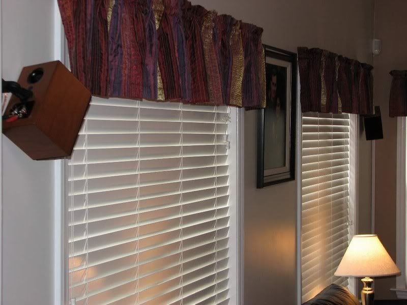

Are you talking about rear surrounds in a 7.1 setup or the side surrounds in a 5.1? If your talking 7.1 I don't think it will be worth it with the couch up against the wall like that.
If you are just wanting 5.1 that you can mount them on the rear wall and point them at the couch, or set stands on either side of the couch and face the surrounds at each other. Neither situation is quite ideal, but they are close enough that it shouldn't be a much of a sacrifice.
Here is an example of side surrounds in a similar situation.
