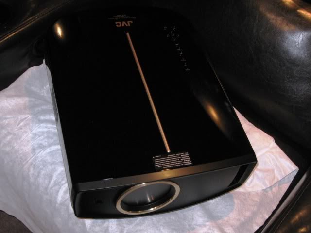

The RS10 is plenty bright for sports and throws a stunning image. Though close in performance, the RS10 still tops those mentioned especially in fade to black, shadow details. For 5k you will be buying the RS20, I certainly didn't spend 5k on mine. I would suggest going to AVS and speaking with Jason as he will certainly give you a deal well under 5k; I will even go as far and say under 4k. The Epson will be brighter, however I think the JVC will be way more than enough. Put it this way, I have the RS10 paired up with a 126" Carada screen using BW material, the Iris is set to mode 2 and it is still plenty bright.
Either should perform well, but if you have the extra coin, the RS10 will last you for a very long time. Not to mention, look how sexy that black/gold looks and that's just on the outside, wait until you see the stunning image it throws
