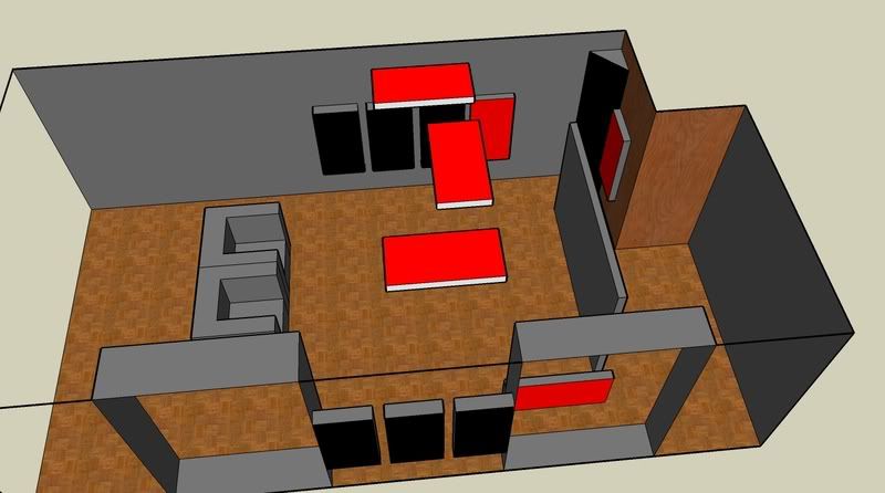

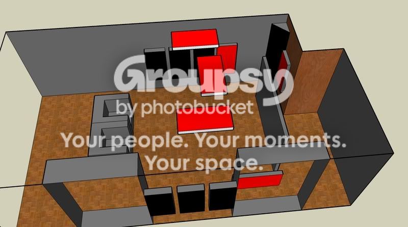

sketchup is actually fun.
i dont have the exact measurements, but here is an idea of the room
with this orientation on the sketchup pic:
there are doors on the lower right corner and lower left corner of the room.
the wooden portion on the upper right is a thin drywall connecting to another room.
red panels are 242
black are 244

what would you suggest?
i was thinking it would be more efficient to replace the 3 244's on my left with 242's (im going to order) and use those 244's as "bass traps" in corners or the back. i will leave the 244's on my right untouched. opinions?
aside from that, i could also build "soffits" on the horizontal corners (ceiling - wall intersections)

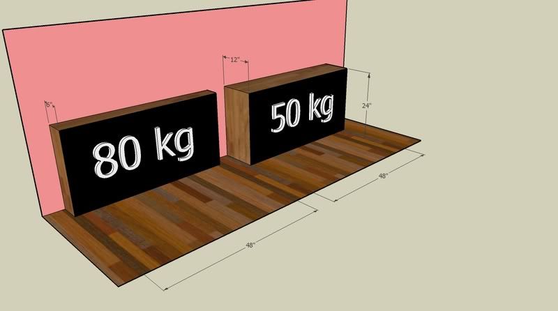

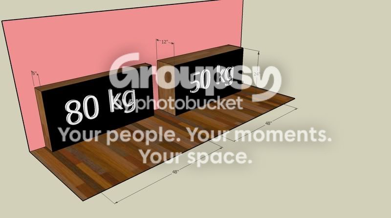

so i plan to use 80kg density rockwool for the rear wall to floor corners like pictured below
1) how thick do i have to make it to be effective?
2) in theory, which is more effective?
6" thick 80kg density
or
12" thick 50kg density (but lets assume this is 40kg for the sake of theory)
3) and is it ok to use full wood frames on the sides of these panels? or do i have to put holes on the sides?

Hi Mike - sorry, been buried.
I'd say that moving the 244's to the rear corners and/or rear wall is a good idea and use 242's on the side wall.
As for the other...
1. I'd want them at least 4" thick - more is better or 4" with an air gap behind
2. 12" of the lighter material will absolutely be more effective down lower in the bass.
3. A wood frame is fine around the perimeter in this application.
Bryan

thanks Bryan, will i get even more of a benefit if i go thicker than 12"
how thick til i reach the point of diminishing returns?
