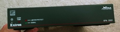

From there, you need to KNOW how they are wired and setup. As mentioned, if they are not installed, they should not be. They are completely wrong. But, if they are wired, in series as they likely would be, then you just need an amp which can handle them. With a maximum of a 6 watt tap, the most 10 speakers would pull is 60 watts of power. This is nothing in the commercial world where a hotel may have 100+ speakers on a single run.
An amplifier like this will take a line level input and convert stereo to mono and deliver 200 watts of 70v available power.

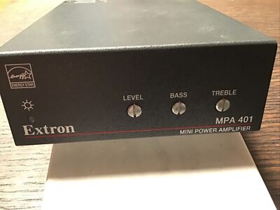

Something like this is decent, but needs a Extron power supply to go with it. It only gives 40 watts of power, so you would need to set the taps at 3 watts.
power: https://www.ebay.com/itm/174759884762?hash=item28b08037da:g:NCoAAOSwVs1f4TBX
You do want to ensure that if you buy one of these amplifiers, then you get one which includes the phoenix connectors on the back of the unit for at least the output connection to the speakers. The 5-position connectors are readily available on eBay or elsewhere. I've gotta have about a hundred of them. They are easy enough to pick up.
