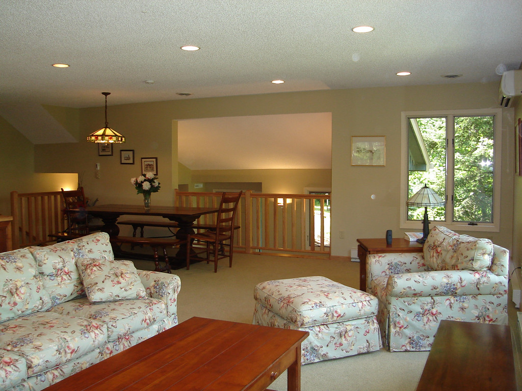

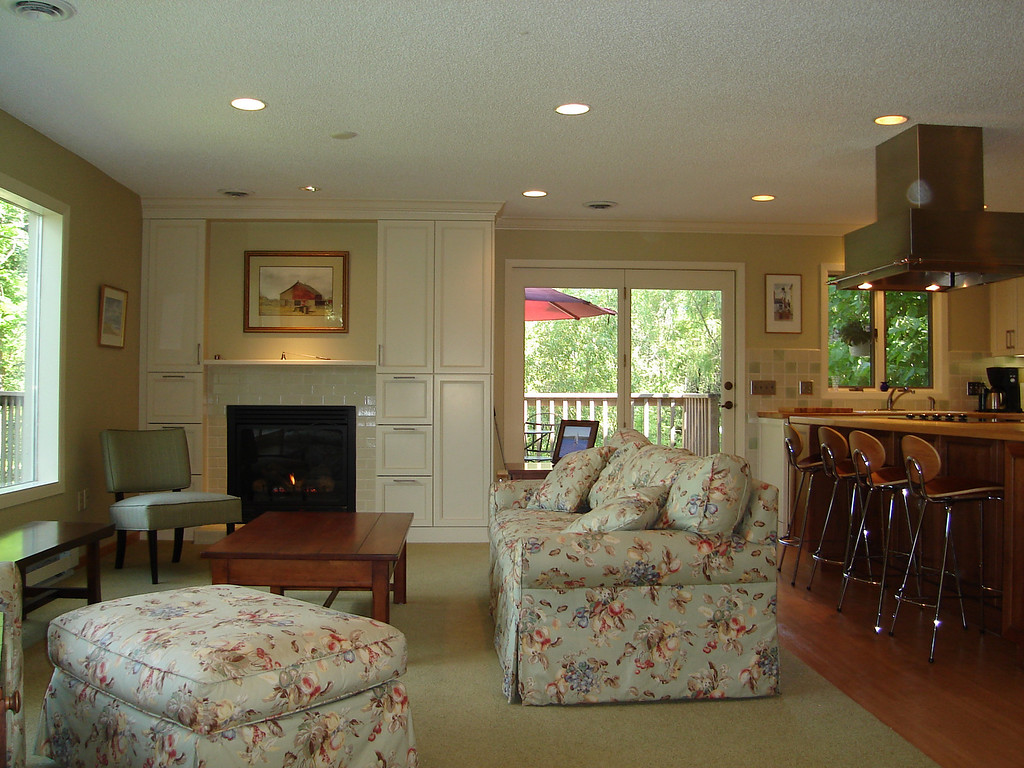

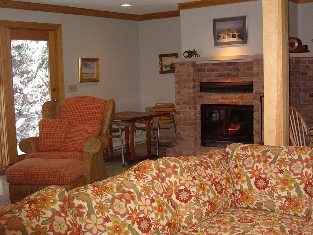

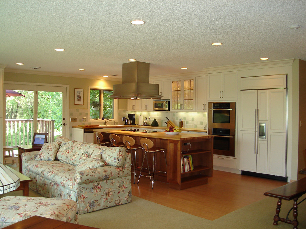

She did our remodel here.
That is a few views of a couple of the spaces.
