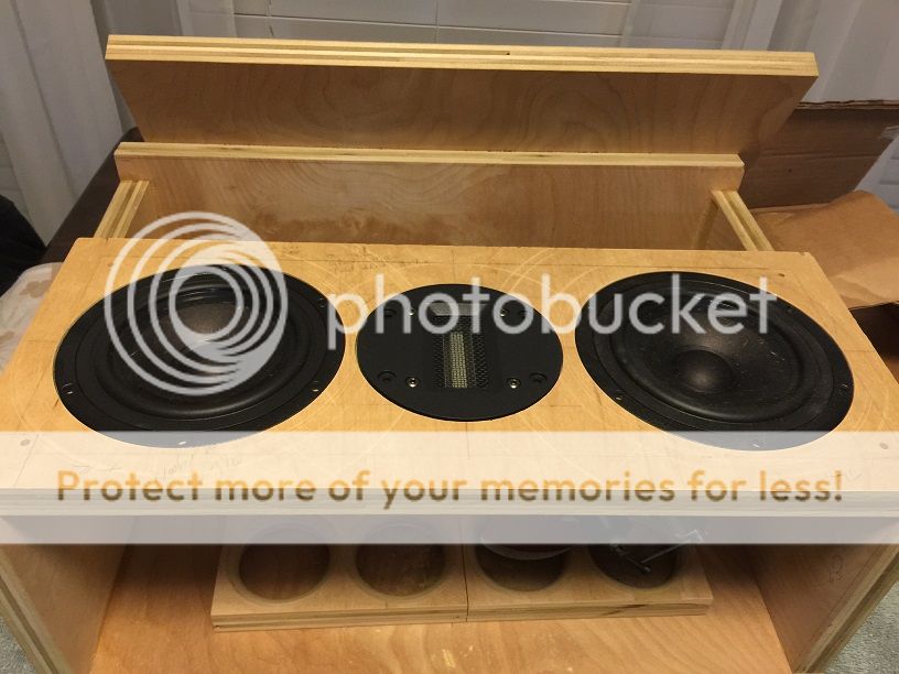

I wanted to document the build of this great center channel designed by Dennis Murphy as well as show how I made the grills for the L/C/R. Obviously the credit goes to Dennis Murphy for designing them but also to ARES24 for posting what I believe is the first build. It really inspired me to complete my front sound stage.

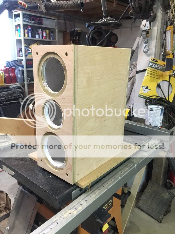

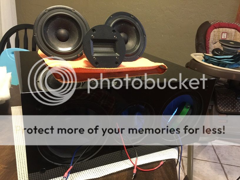

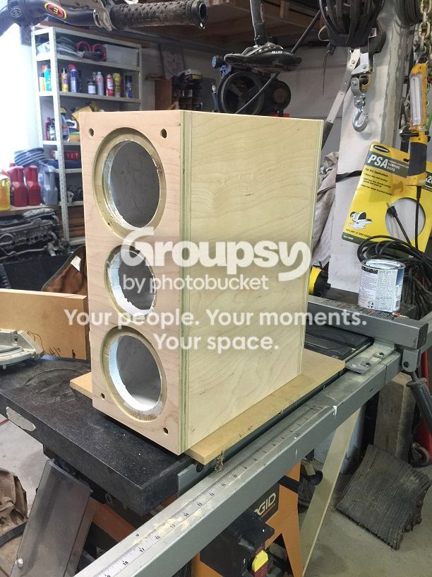

Basic box construction, glue only, just say no to screws. Experience has led me to believe that no matter how hard you try to cover screw holes, you will always see them. Not sure if they all do but the wood filler and body filler I’ve used in the past seems to shrink over time exposing where your hole was. Friends may not be able to tell but you will know.

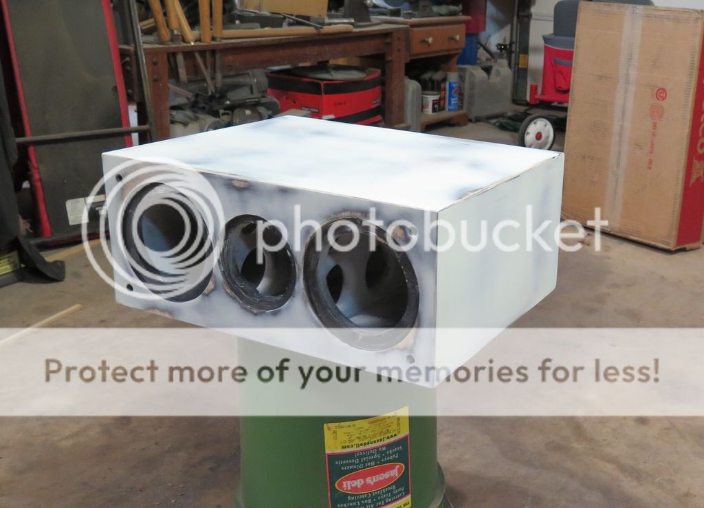

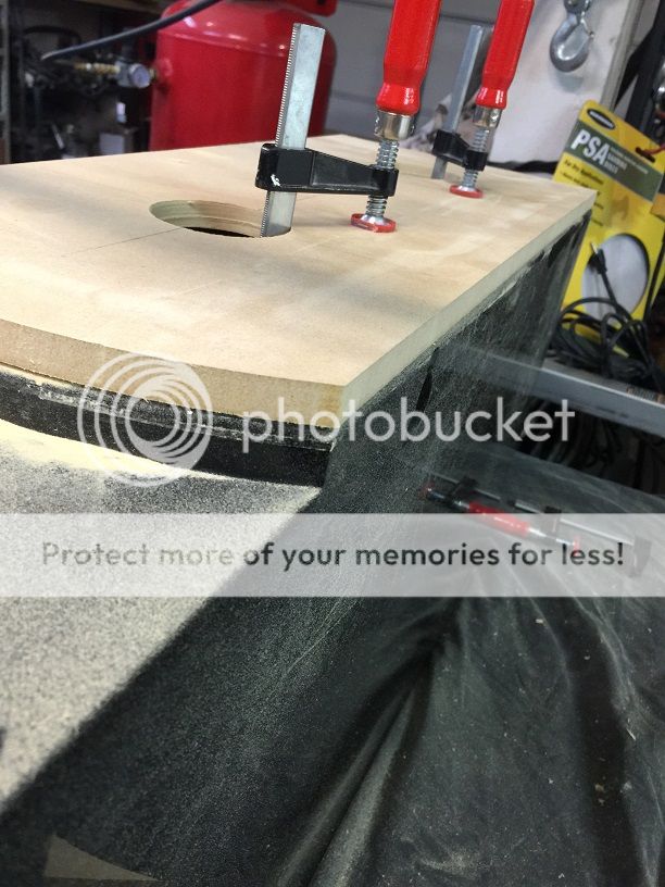

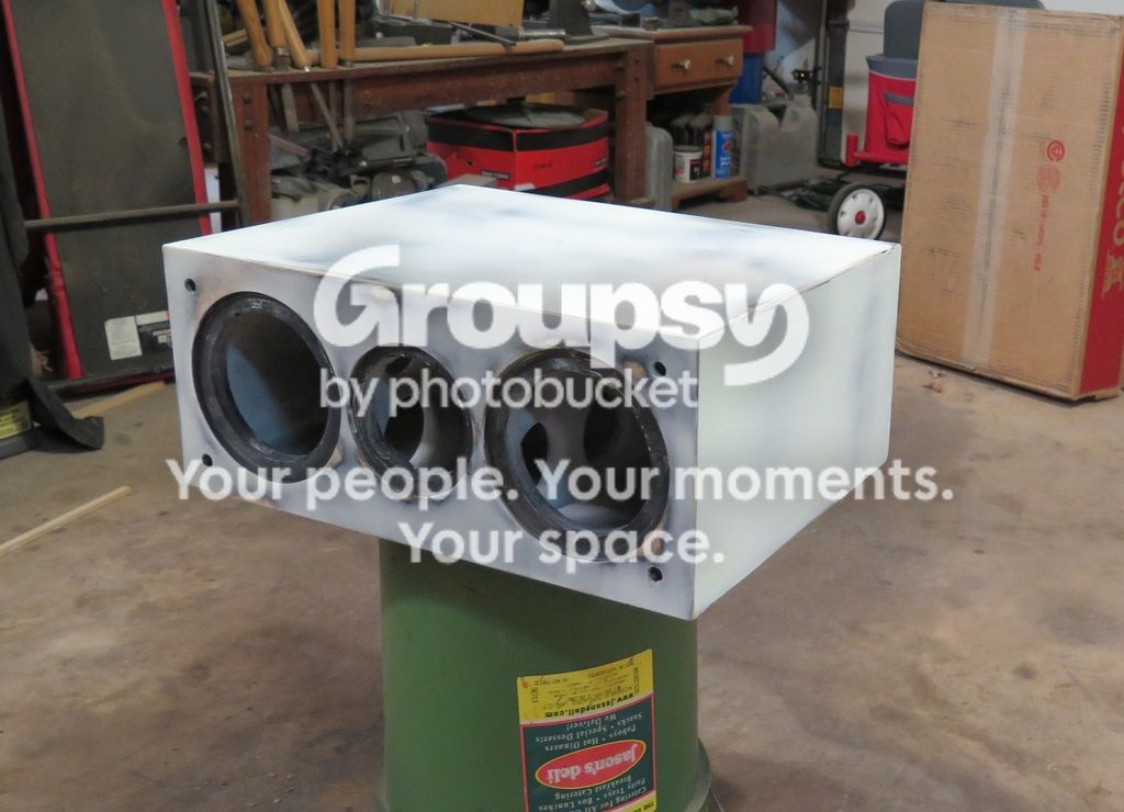

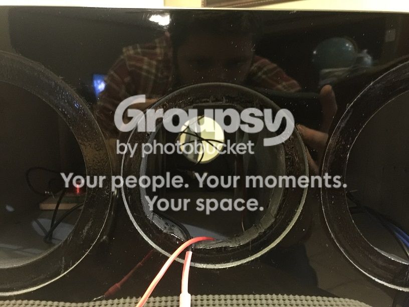

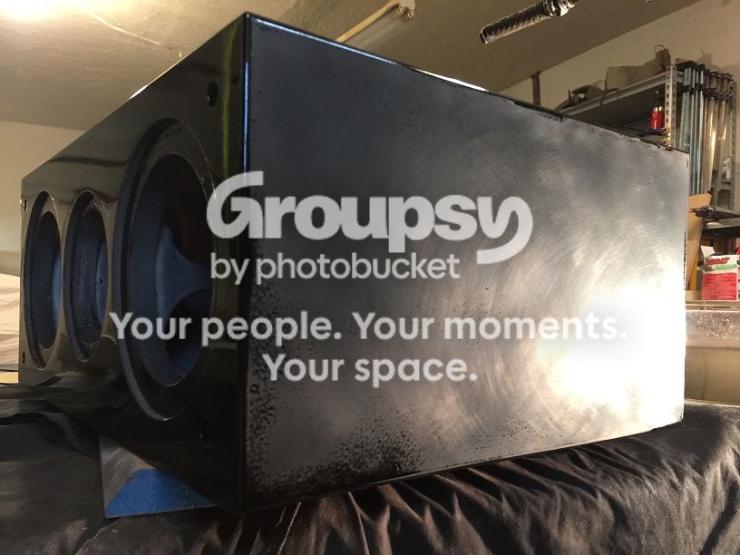

I wanted to try an automotive, single stage paint and thought I should prep the box like it were a body panel. Here it is with a layer of Dolphin Glaze. I blocked it the best I could 220/320 grit sandpaper before spraying 2k primer.
Hit it with two coats of 2k primer, blocked with 400. You might have to reapply the primer if you sand through on certain areas. It's a small box, block it like you've never blocked it before.

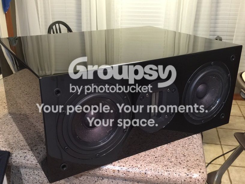

Three or four coats of high gloss, single stage automotive paint from the local body shop. The reducers and hardeners are specific to the product so it can add up in a hurry. Also, a good degreaser/dewaxer is advised since you’re going through an awful lot of effort and money. Next time, I would put a few extra layers on all the corners first to build up the areas susceptible to burn through when buffing. Or if you’re not worried about running out of product, simply put several more layers down over everything. Three is just barely enough. In this picture I have begun the wet sanding process on one of the sides since I had some orange peel. In the end, every surface was sanded with 1500 then 2000. Remember, a lot of effort goes a little ways, so be patient.

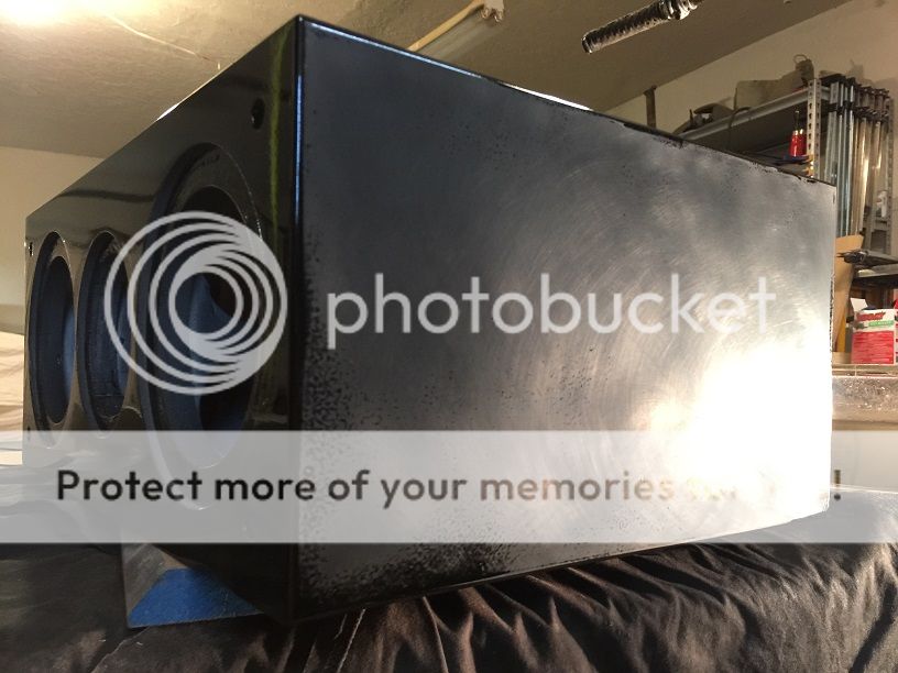

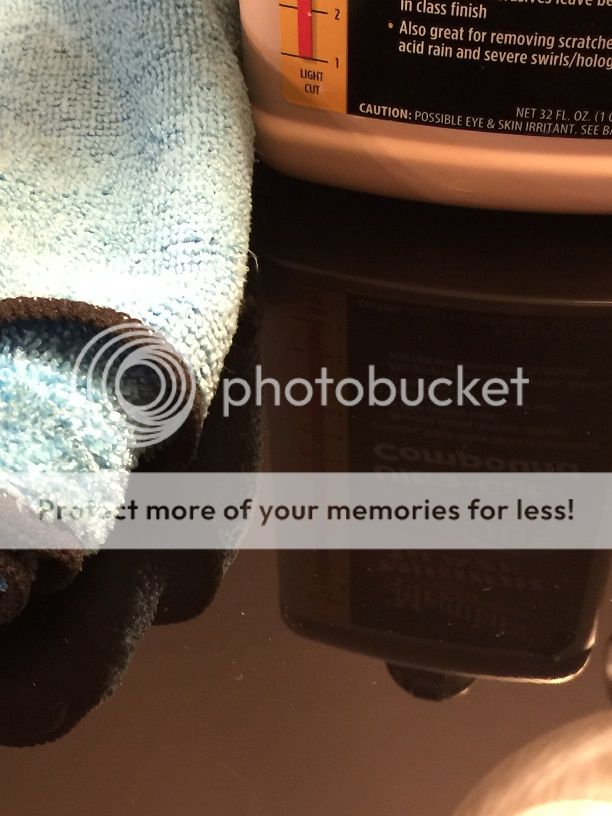

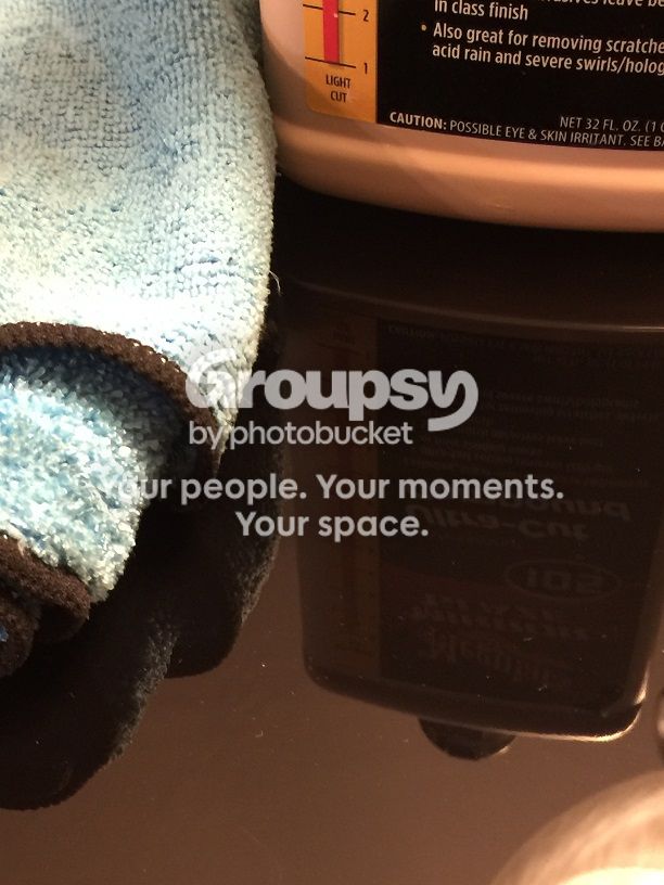

Polished with MeGuiars M105 cutting compound with a Flex 3401 dual action car buffer. M205 polish was applied next followed by an automotive wax/sealer. I got about 98% the scratches out. Had I put several more coats of paint on, and maybe wet sanded up to 2500, I would have gone for that extra 2% or so but I had a hard enough time finding the imperfections under harsh lighting conditions. I figured where it sits under the TV and out of the sun’s light, I would never see it. Dam that 2% though.

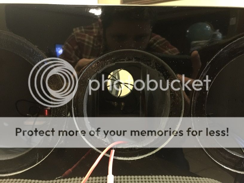

Had to be real gingerly with the buffer on this side. Everywhere there is a hole, the buffing pad wants to fall in the hole and then dig into the edges every time the pad circles around. This can cause you to burn through the paint and expose the primer if you’re not careful. The specs of white is just dust, not primer.

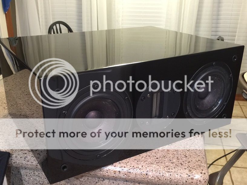

And boom, piano black. At least I think. Is piano black just another name for gloss black?

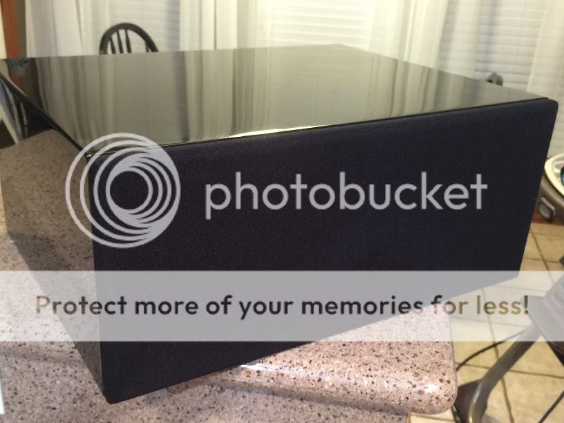

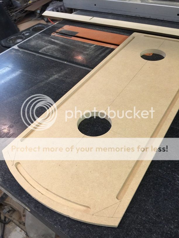

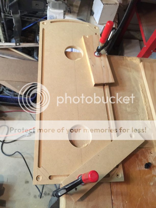

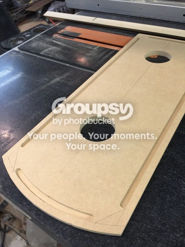

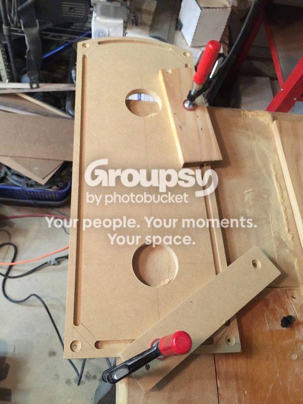

This part will attempt to walk through my process for the grills. The one shown is for the ER18’s but the same principles apply.

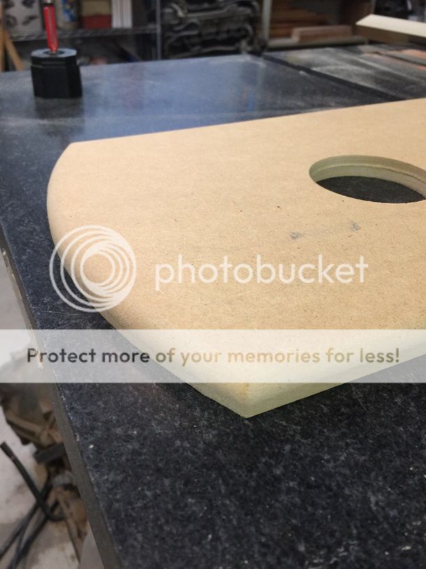

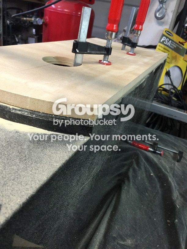

Using a flush trim bit to size the frame perfectly to the baffle. Also helps when your cabinet isn’t perfectly square; the flush trim bit doesn’t care. Use this opportunity to match drill your speaker mounting hardware.

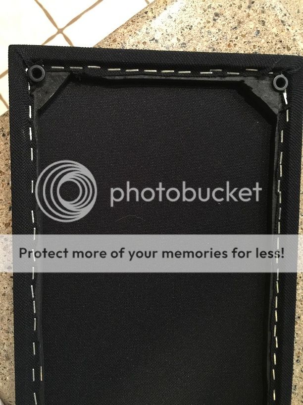

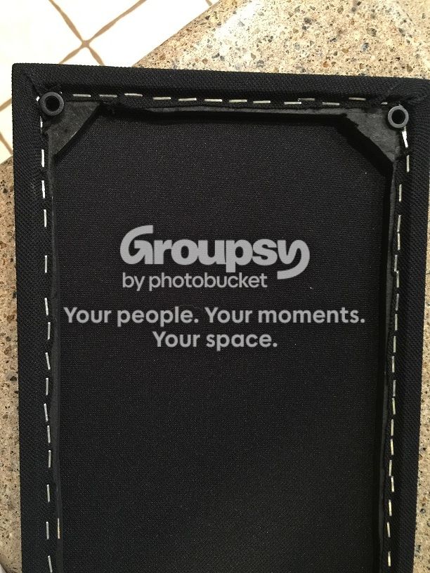

It got a little tricky here for me but I just wanted a rabbit for the grill cloth to sit in where I could staple it. I did not want to staples up against the paint.
Not shown here is the jig saw used to cut out the middle.
Stretch the fabric too tight and you’ll flex the frame, too loose and you’ll get wrinkles. My next frames will made of real wood and not MDF. Oh and put as many staples as possible.
Dun and dun.

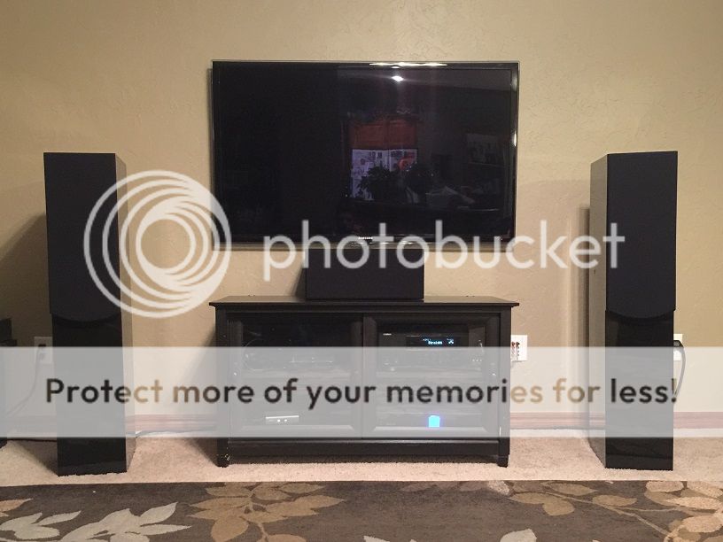

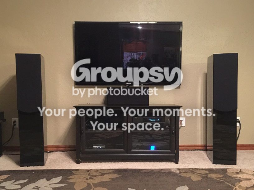

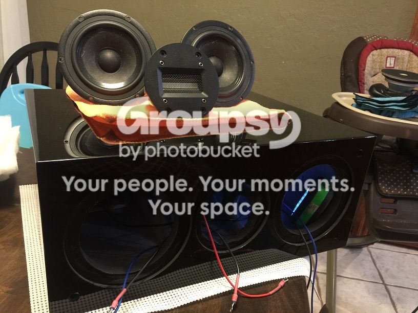

It’s been a long time coming but it’s finally done. Although I really need to refinish those ER18s with the single stage paint for it to really match.

That's some slick work with that HVLP. How do you like having a center channel? How long has it been in use? Do you have crossover pic's?

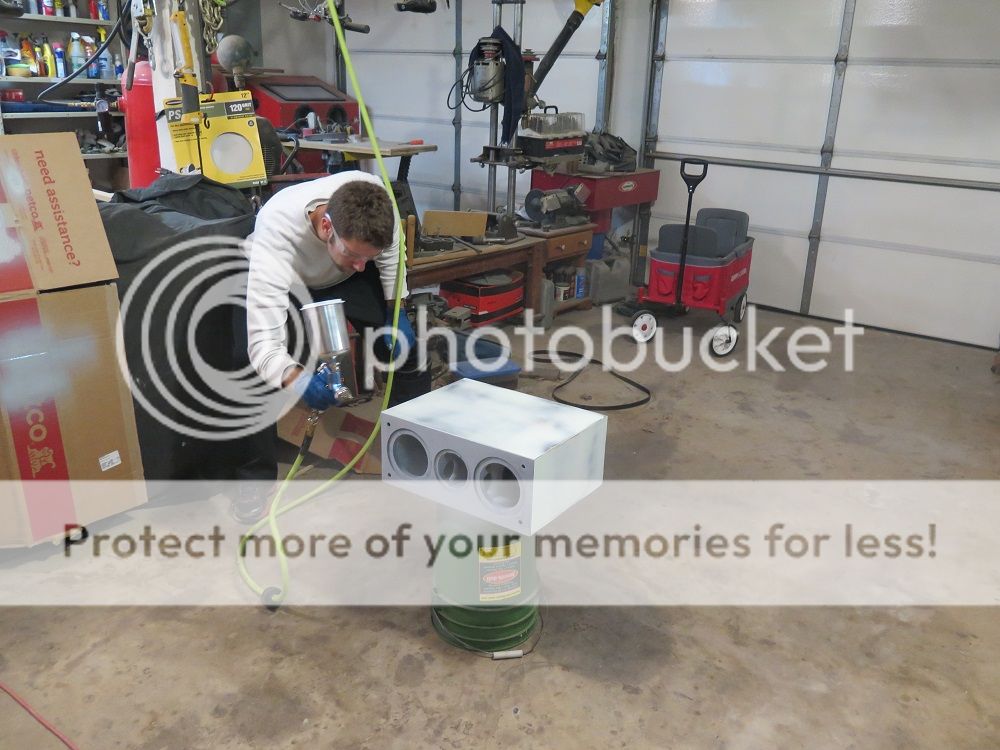

It's not quite a HVLP but a "high efficiency" gun. It beats rolling on the finish if you can minimize orange peal and it gives you more options if automotive paints are a consideration.
Having a center channel is very nice. It relieves the towers of that unnecessary load and really cleans up the movie sound experience. It's not as transformative as going to the ER18s were but it really rounds out the system. It's been in use for about a month now. I'll see if I have a pic of the crossover when I get back in town.

I'm surprised Sean got those cabinets that shinny but that's the right paint with some serious buffing, polishing, sealing etc. I would have expected humidity and dust control to be bigger factors. That's my excuse for finish disasters.

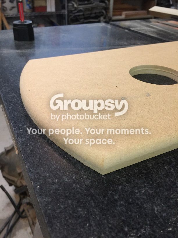

As for the end grain, I used a product by U Pol called Dolphin Glaze. It's basically a self leveling body filler that is arguably better than bondo, depending on what you're working on. While not all "bondo" is created equal, this glaze is easier to work with and sands VERY easy without clogging the paper. It's more expensive than bondo and doesn't build as thick so it has its limits.
If you look at the 3rd and 4th picture, you can see the application of the glaze (not primer) over nearly 100% of the box, including the end grain.
I tried to minimize the wood's natural tendency to expand and contract, which would expose the outline of the edges under the finish, by applying several coats of primer to the inside. I guess time will tell.

That's a killer center for $300. What was your body shop bill? Looking around your garage I spotted the drill press and the parts washer. Nice. I guessed at the model # for your rec'r. I just knew it was after 663. I would imagine your version of YPAO is the same as mine and I've been playing with mine but the results are a mixed bag. I actually have YPAO on two rec'rs, the 663 and 2600. I guess the difference is that the 2600 lets you see and adjust the auto set up which includes Q adjustments making it a parametric EQ. The 663 which I believe is similar to what's in your 665, auto PEQ once set, can't be seen and used as a starting point for fine tuning. You can adjust the GEQ at several points which is cool. There's definitely stuff to know about Yamaha's room EQ. After a few years of ownership I'm just now starting to see what can be done. I think I might be at the stage where I figure out how to use that mic and mixing board for measurements.

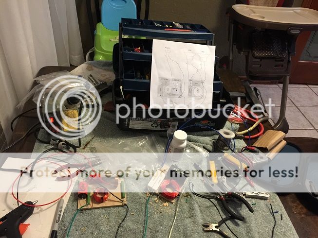

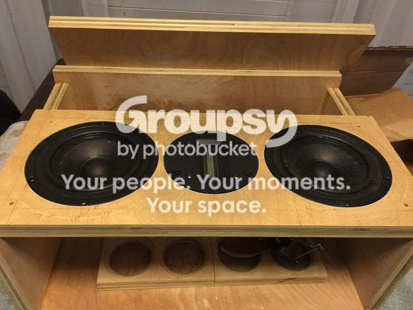

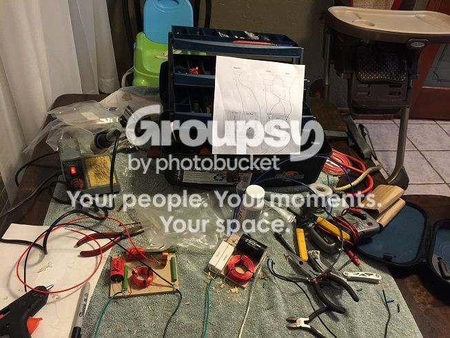

Crossovers. Unfortunately I don't have better pics than this. Maybe some computer whiz could blow it up, enhance it, and repost it.

The body shop bill included the dolphin glaze, qt of 2k primer, 2k activator, qt of paint, paint activator, reducer and dewaxer/degreaser which ran about $150. I am in the middle of a mustang semi-restoration so all the leftovers will be put to good use. Otherwise a quart of each would have been overkill even though I'm not sure they sell in smaller quantities.

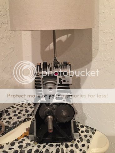

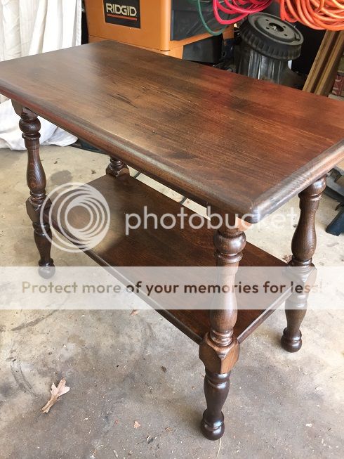

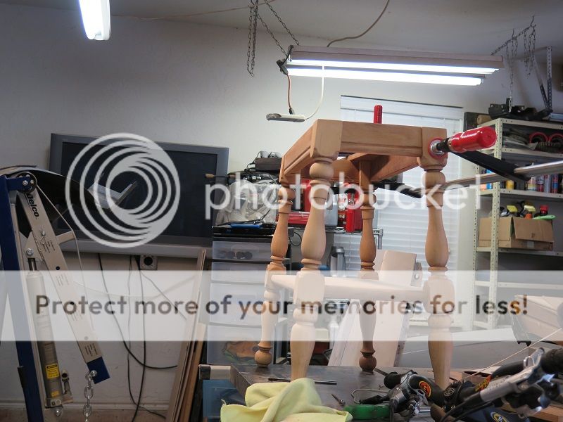

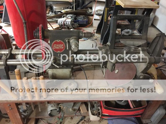

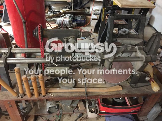

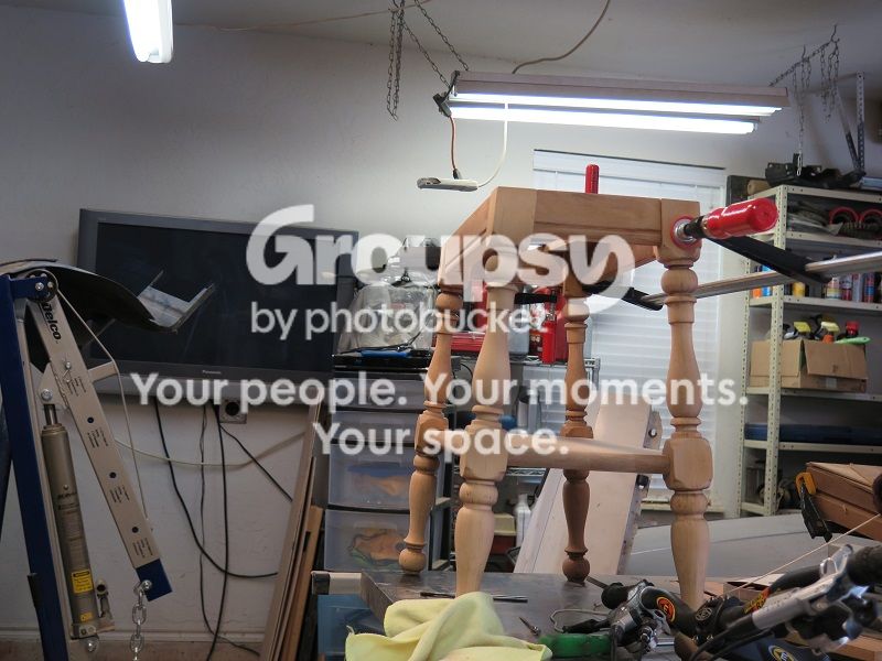

The garage has been in constant motion since the last time you saw it. Tools always coming and going and varying stages of cleanliness depending on how many projects are going at once. That drill press you spotted is actually a 1947 Shopsmith 10e that was gifted to me. It was the only year they ever made it because in 1948 they revised it, calling it the 10er. I'm not sure if they ever stopped producing them, I see all the different generations going up on Craigslist all the time, some new, some old. This one only took a few days of painstaking work to get the stocks to slide as it was rusted all over. It converts into a drill press, 12" grinder, table saw, jointer, and a couple other things I'm not aware of. It's cool and does a lot of different things but doesn't do any of them very well. Good enough for my skill level though.
Everything still works though and it's taken me through a couple of neat projects, including a night stand that belonged to Erin's great grandmother.
The parts washer I've been needing for the longest time and couldn't pass it up when I came across it at a garage sale. I had to piece together the drum and replace some of the hoses but I still have less than $75 in the whole thing. First order of business once I got it running was this little engine lamp I'd been wanting to build for years. Fully functional too.

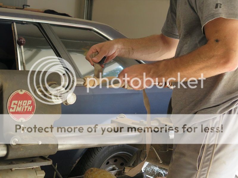

That Shop Smith is awesome. That end table is similar to my coffee table. I used Eddie's lathe to sand the legs down to bare Maple. Is that what yours is? I gotta get to Eddies today to get a power cord for the Oppo. I robbed it to power up The Ampstrocity in ManTown. I'm going to get my measurement gear from down there too. This could be my year. The year I figure out REW. The Behringer DEQ 2496 might be too much to hope for though.
The crossovers look good too.
