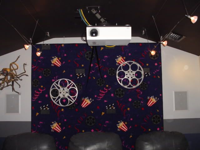

Just out of curiosity. I just received my 7500UB yesterday and started mounting today. Did the mount that came with the projector not work?
It's exact match for my previous mount, a Premier Mounts universal. I'm able to use the dedicated mounting plate for the Epson with the existing mounting system. The mount allows for full tilt in swivel in all directions.
http://www.premiermounts.com/product.asp?PartId=1391#
Here's the same mount with my old Optoma projector. It allowed me to offset the projector to one side by mounting the bracket sideways, just like an angled ceiling.
