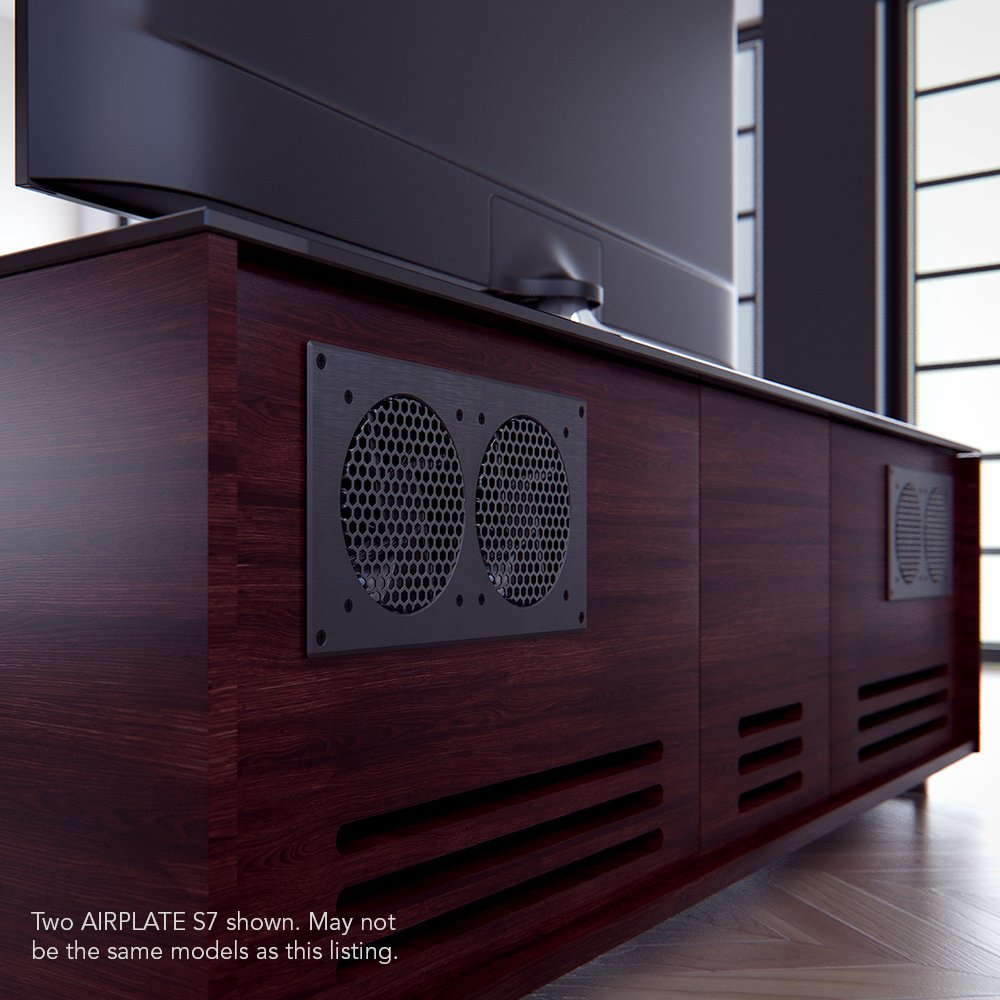

AudioAdviser is usually overpriced for what you get!
Check these out ($36 each):
https://www.amazon.com/AC-Infinity-AIRPLATE-Cooling-Cabinets/dp/B009CO543S/ref=sr_1_6?ie=UTF8&qid=1517291707&sr=8-6&keywords=ac+infinity
Of course, you still need to make sure the air flows through/around the units rather than just up along the cabinet walls. For a situation like the picture above, it would be ideal to put the hottest unit at the top and the coolest on the bottom; and drill or slot the shelves to allow easiest airflow wherever there are vents in the gear's case.
Also get a cheap laser thermometer gun to establish/monitor temperature improvements!
https://www.amazon.com/Etekcity-Lasergrip-774-Non-contact-Thermometer/dp/B00837ZGRY/ref=sr_1_sc_1?s=hi&ie=UTF8&qid=1517292286&sr=1-1-spell&keywords=laser+thermometeer
