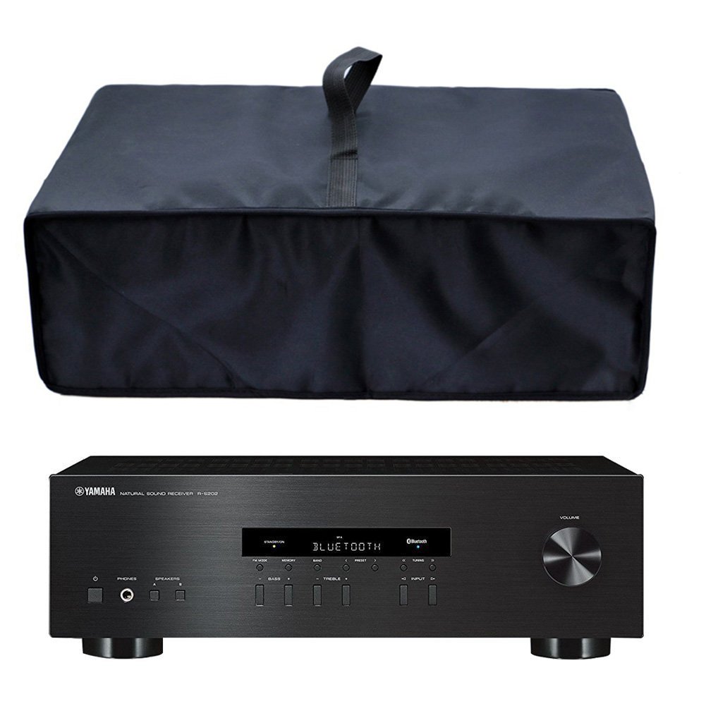

I have a serious dust problem. It's very dry out here and I don't have grass in my back yard. I have 2 large dogs who love to play outside and a sliding glass door next to my equipment, where it's the worst. I dust probably every other day because it doesn't take long to accumulate. I have significant buildup that I can see through the vent holes of my receiver and amp and it has me worried. I stumbled across one of these designed for a Yamaha and am wondering if you guys are familiar with.
Right off the bat I see issues with overheating by trapping more heat inside, but dust can be a killer too. Thoughts? Is this just a bad idea from inception?

Cover it only when it's not in use! Asking for trouble.
Buy a couple of decent HEPA filters. I have 1 in the L/R and another in the B/R. Leave them running 24/7, except maybe for movie night or critical music listening.
I have a few pets, and HEPAs absolutely help with pet hair and dander, and general dust, and allergen removal too. On that note, upgrade your AC air filters to the best that you can afford!
EDIT: I started with 1 HEPA, and the first time I changed the pre-filter, I immediately bought a 2nd when I saw the condition of the pre-filter. Also, note that a single HEPA filter should be a 1-time purchase unless you mistreat it, even if it isn't advertised as a "liftetime HEPA filter".

I too, am a fan of the HEPA air purifiers. Be sure to price the replacement filters because some of them are like ink jet printers - they are happy to give you the unit for free if it sucks you into paying a premium for their unique filter. Also you should be able to find one where there is a separate Carbon/large particle filter from the HEPA ($$$$$) filter so you can replace it more frequently with all of the dust you are getting in your house!
Just brainstorming - looking at alternatives:
1) Use it as an excuse to add a vestibule (kind of like an air-lock on a spaceship) to prevent dust blowing straight into your home.
2) Enclose the gear in a cabinet and add temperature activated exhaust fans like this:
Install a good air filter at the intake point and you can do something like drilling 3/8" holes on one inch centers to allow airflow where you want it through walls or shelves.
3) Add an underground sprinkler system on a timer in your backyard to keep the dust under control. When I worked construction at one of the local nuclear plants, they used water trucks to spray the dirt roads to prevent dust from getting out of hand. The trick is enough water to get things damp without creating mud-holes! If your dogs go out on a schedule, like in the morning and after you get home from work, then you only need to run it a few minutes before these two events.
4) Pea gravel in yard?

I agree with [B]slipperybidness[/B], cover it when not in use. I have the same problem here in Tuscon, dry as a freaking bone most of the time, and lots of dust. It actually caused issues with my Oppo 105. I had to send it in for repair and the mentioned the dust build up. I bought the expensive air filter for our A/C, as I understand the best quality ones do make a difference. I have gone six months with out changing filters too. This is not recommended. Change em after 3, if you don't already.
