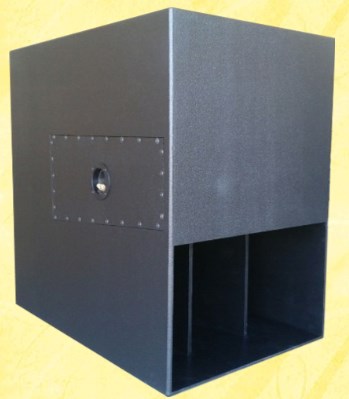

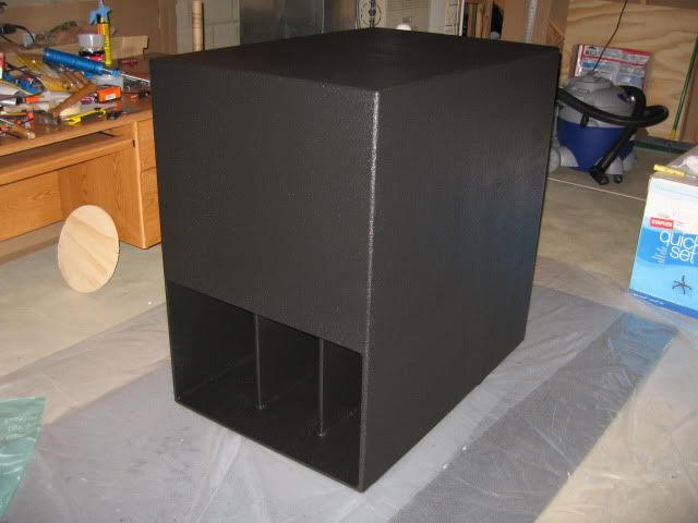

Conflicting reports so far on the LP cutoff......but I might just be going with something else, thanks in part to RMK with his TH-SPuds and now this. The parts list is easy on the wallet, very, very efficient(read: inexpensive amp) and just amazing output.....with just one $150 Dayton woofer.
http://billfitzmaurice.net/THT.html
