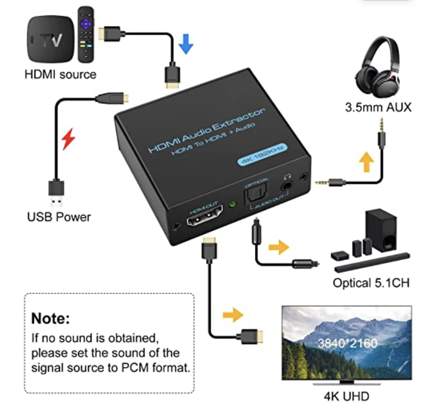

Hello and welcome. You can get 5.1 audio to your current receiver easily enough by connecting the Firestick to an HDMI audio extractor that will send the video to the projector and the 5.1 audio via optical to the receiver. You will need an optical, HDMI and Y Adapter cable for an additional sub as well as the extractor. You can get the extractor and cables for just a few bucks. Results will vary with different devices of course.
