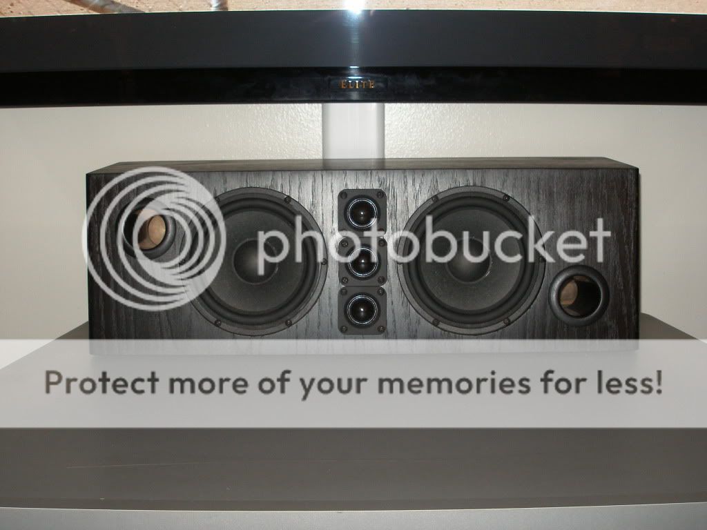

I feel that my front stage is far too narrow sounding on voices. Wondering if adding a second VR12 side-by-side with the current one would help or hurt my system.
Wired parallel at 4ohm, the receiver is supposedly able to handle this.
Thoughts on the idea, the setup and tuning?
The VR12's are quite inexpensive these days, and I am intending to buy a couple more anyways to use as L/R channels on stands to replace my 960's

Dual center channels can cause comb filtering. This has been discussed before, and the consensus was that it should not be done.

What exactly do you feel is wrong with a single center? Is it too localisable? Is it too quiet?

Too localized. have tried a few different models over time (have changed my entire setup a number if times now, of course all timbre-matched)
Feels that it should really be wider and more full. This setup has been my favorite so far, but still feels lacking. Am moderately familiar with tuning the built-in MCACC with the Elite. Have tried countless settings and am pleased with the tone, but the spacial dispersion is not what I am hoping for. The VR12 is supposedly quite adept at handling that, but I am not hearing it.

I have read that people have tried to run dual centers one above the screen and one below. So you could try that, but to run them side by side no. Try moving your center around, check the settings it might need to be adjusted. Run some pink noise from your recevier to check the level of all your speakers. If it was me I wouldn't run two centers check your levels first, but if you wanted to run two go one top of the screen and one below. Have a good one.
I've tried dual vertical center channels (2 CLR3000 speakers), and they sounded like crap due to comb filtering.
You can try to upgrade to just ONE bigger center channel.
But stay the heck away from duall center channels.

Hard to get bigger than I have without getting into the outrageous price range.

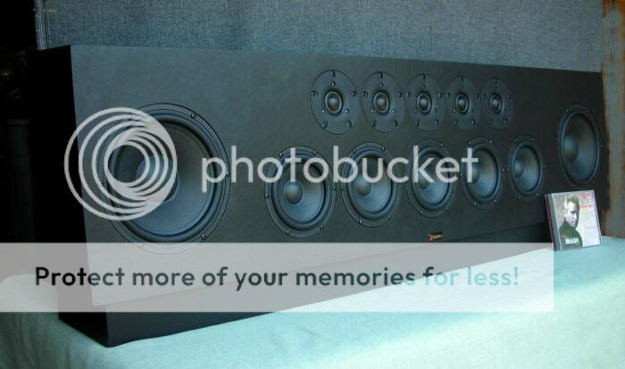

I've played around with dual centers a while back. It was OK. My next upgrade is going to be the center. I used 2 identical speakers top and bottom, at first I was impressed but went back to single speaker.
I am going from this
to this
That'll be my 5th and last upgrade on the center. I think go with one nice big center. IMO 2 good speakers don't make one great speaker.

What Center is that Walter.... ? Its huge and kinda reminds me of the old Polk Audio of the very early era's, like SDA. I am not familiar with that one...
Docks
Haha thats a badass center!
I was going to suggest the C5 prior to your photo. *Not my setup*
That's a nice center. I would'nt mind owning that one. That is a hell of a nice system.
