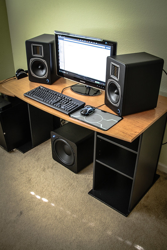

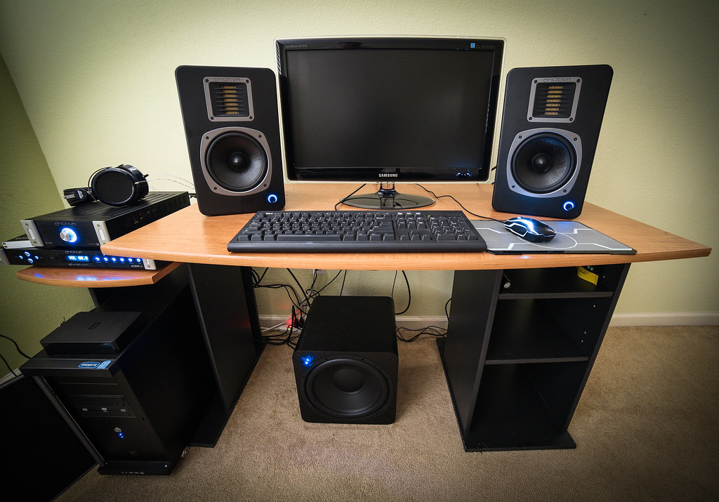

For music in a 2.1 desktop/computer setup, I paired the SB-1000 with my Emotiva Airmotiv6 powered studio monitors.

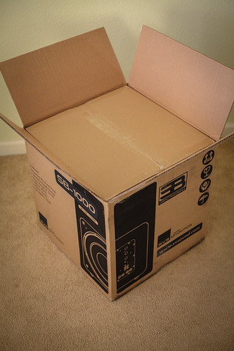

PACKAGING:

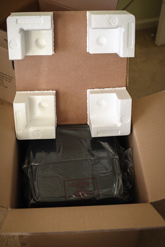

SB-1000 arrived in a medium sized box, the SB-1000 by itself only weighs 27 lbs, but with all the packaging it probably weighed around 35 lbs or something? Don’t quote me on that though.. I was able to carry it up 3 flights of stairs without any problems. It is double boxed and contains sturdy packing materials-padding/styrofoam around the edges, the sub is wrapped in a plastic cover. Came with a power cord and an instruction card.

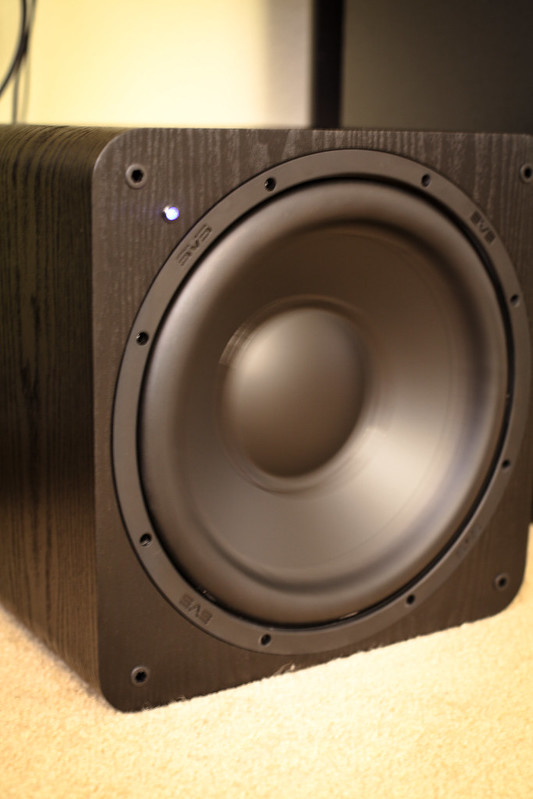

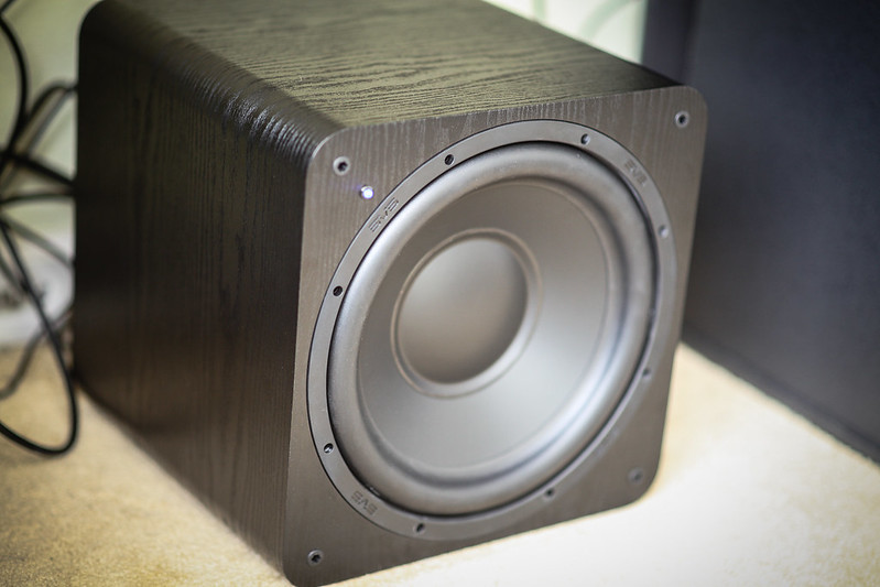

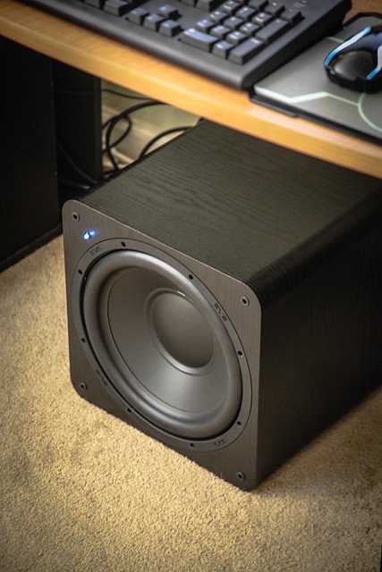

The SB-1000 has a small 13in x 13in x 13in footprint so you can easily throw it under your computer desk like I did, or place it anywhere in your room, it really doesn’t take much space. It is targeted for users who are looking to utilize it in a small to medium size room. The front of the sub has an LED which lights up blue when the sub is active. In my case, the LED light fit right in with the inadvertent blue-light theme of my system (take a look at the photo below).

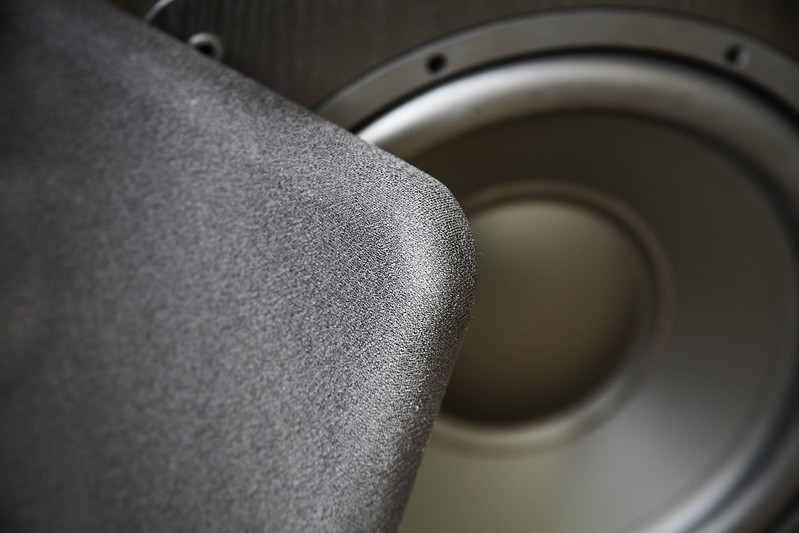

The SB-1000 is a black ash painted wood enclosure. The black ash has a smooth finish, and is textured. I think it looks pretty good.
Because it is a sealed sub, it should be bit tighter/faster and less boomy compared to ported subs when it comes to handling musical bass (*spoiler*
and yes it is!
). It will not reproduce subsonic bass frequencies like its other ported $499 counter-part, the PB-1000 (per the specs, the PB-1000 goes down to 19 Hz). So if you're specifically looking for more spl/volume in the low end frequencies and don’t care about distortion or resonance caused by the sub port, and you mostly watch movies or play games, my guess is that the PB-1000 might be a better fit for you. I wanted a subwoofer to use for music, so the SB-1000 is a better fit for my situation.

Computer office/room dimensions: 12ft by 14ft, with an 8ft tall ceiling, carpeted. Sub underneath desk, and also tested with sub on the side/corner near wall … = louder, boomier..
For the PC audio, all testing was done using FLAC files with JRiver Media Player (bit-perfect),ASIO output via the ASUS ESSENCE STX sound card-> RCA line out -> SB-1000 RCA in … SB-1000 RCA Out -> RCA in Emotiva Airmotiv6s. ASIO mode bypasses the built-in Windows sound mixer completely resulting in higher sound quality, less distortion. The SB-1000 crossover was set to 80 Hz and 100 Hz. Both settings sound good with this setup. Volumes were set at 100% for my sources and I controlled the actual volume via the sub volume knob and the studio monitor volume knobs. 65-75% of the max (for the sub & the monitors) were usually too loud for me to comfortably listen to.

Personally, I was very pleased with the Airmotiv 6 / SB-1000 combination in a 2.1 music setup in a smaller sized room. They sound amazing together and complement each other very well. I enjoyed the SB-1000 the most with hip hop and dubstep tracks.

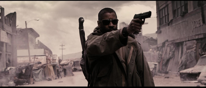

Book Of Eli
Book Of Eli:
The scene I reviewed is the shootout in the middle of the town. Just like with the Luther Vandross track, if you don’t use a sub or your speakers aren’t capable of low end frequencies, you will miss out on a lot of the “thump” and bass impact that exists in this scene. Each time a gun/shotgun is fired, the shot is accompanied by a fast and deep LFE bass thump (watch this scene if you have the movie, and turn up your bass). The SB-1000 reproduced the explosion bass frequency well and was able to produce a bit of impact/punch. The SVS PB12-Ultra/2 reproduced that same bass thump sound but also punched me in the chest and in my ear drums much harder. My seat rattled and made me feel like I was getting shot by the sound-wave. SB-1000 did not have the same punch.

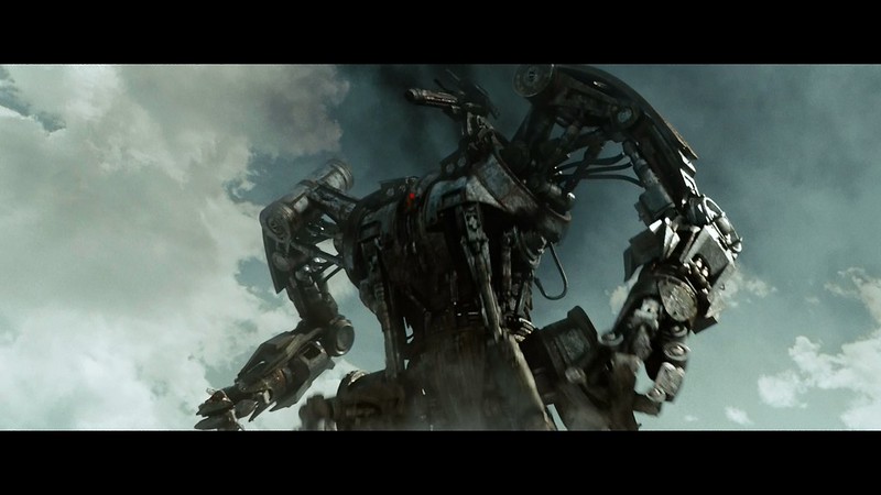

Terminator Salvation
Terminator Salvation:
I LOVE the bass produced by the giant machine foot-steps and the mechanical whirr. This movie is filled with awesome LFE effects. Both subs played the LFE loud, the SB-1000 was quicker/tighter and more detailed than the PB12-Ultra/2 so I actually enjoyed that part, but the Ultra/2 shook my place like an earthquake with every explosion and machine foot-stomp. Together in unison, this scene is amazing and makes the hairs on the back of my neck stand up.

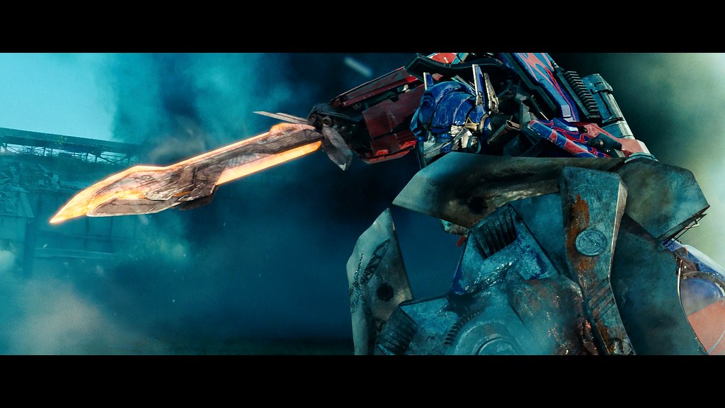

Transformers 1 / 2 / 3
Transformers 1 / 2 / 3:
Even if you’re not a fan of this trilogy, you have to appreciate the sound quality and LFE effects. Filled with hard hitting explosions, bassy robotic movements, and other misc LFE detail –even in the helicopter blades spinning have bass effects. AWESOME
**The distortion in the youtube videos is from the camera microphone, not by the subwoofer distorting.
There are too many scenes to talk about. Overall, I loved the detail the SB-1000 was able to produce but it left me wanting more, more impact and punch. The SB-1000 shines when it comes to reproducing tight detailed bass in short bursts whereas the Ultra/2 was easily able to reproduce loud constant hard hitting bass with ease.
