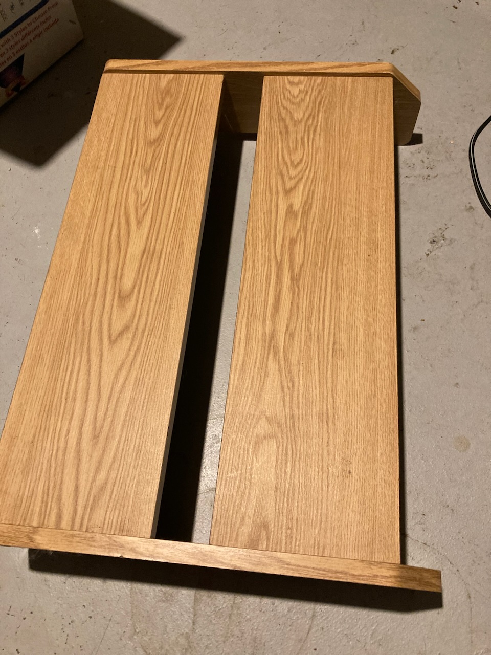

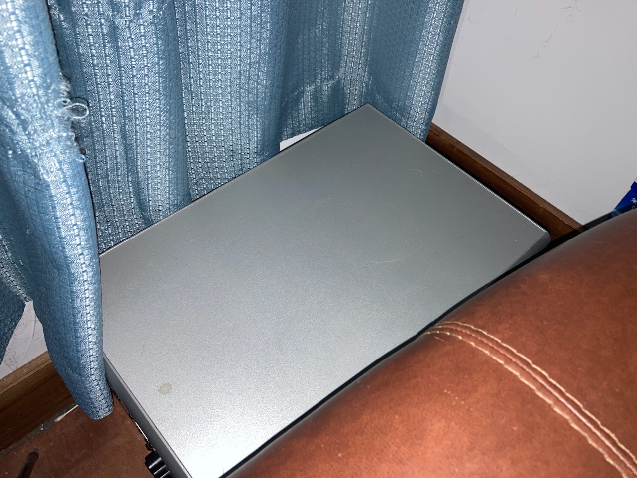

I was wondering if I need anything under it floors are hardwood, and I had it in a riser I took it off not sure if I should place it back on-top it ?
It’s a foot from the corner , beside mlp. I got no other places to put it.

If you hear vibrations from the feet rattling on the floor, you might want to put something soft under the feet to damp the vibrations. Otherwise, I wouldn't worry about it.

So the riser shown above wouldn’t help separate it from the floor?

That riser won't do anything to reduce mechanical vibration. you need something soft between the subwoofer and flooring, a material that will absorb the vibration of the enclosure. Soft foam would work. Some layered fabric would work. Soft rubber should work too.

I guess that riser is useless , not sure what it’s actually made for …?? o_O

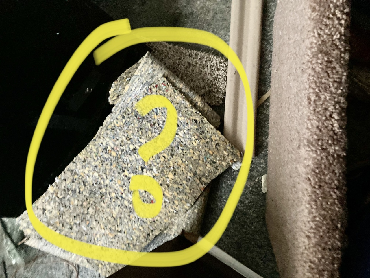

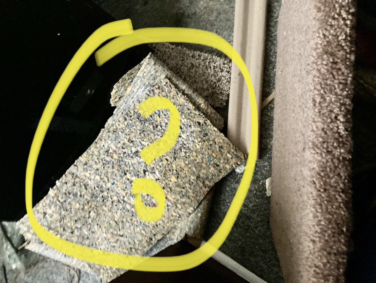

Could I try something like this or a layer of carpet ? This stuff goes underneath carpeting.
I’ll try 2 layers of it see if it cleans up the muddy bass.
Is a foot from corner fine or should I place sub up against the corner??? :eek:

If you are getting muddy bass, the problem is likely the location in room rather than isolation. If you have no other place that you cab place the sub, you should try equalizing it. That carpet padding probably would work to reduce some vibrations, but unless you are suffering from a bad floor rattle where the sub is at, it's not likely to be a major cure for your problem.

The floor is unfinished, my mom ripped out the flooring then never fixed it . The padding seemed to help the sound a little bit.
