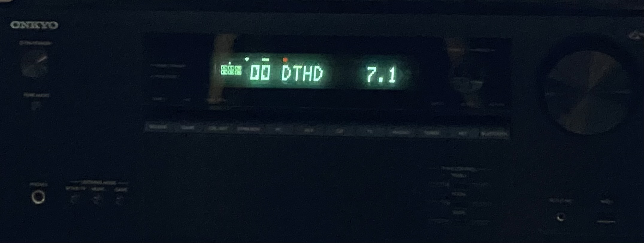

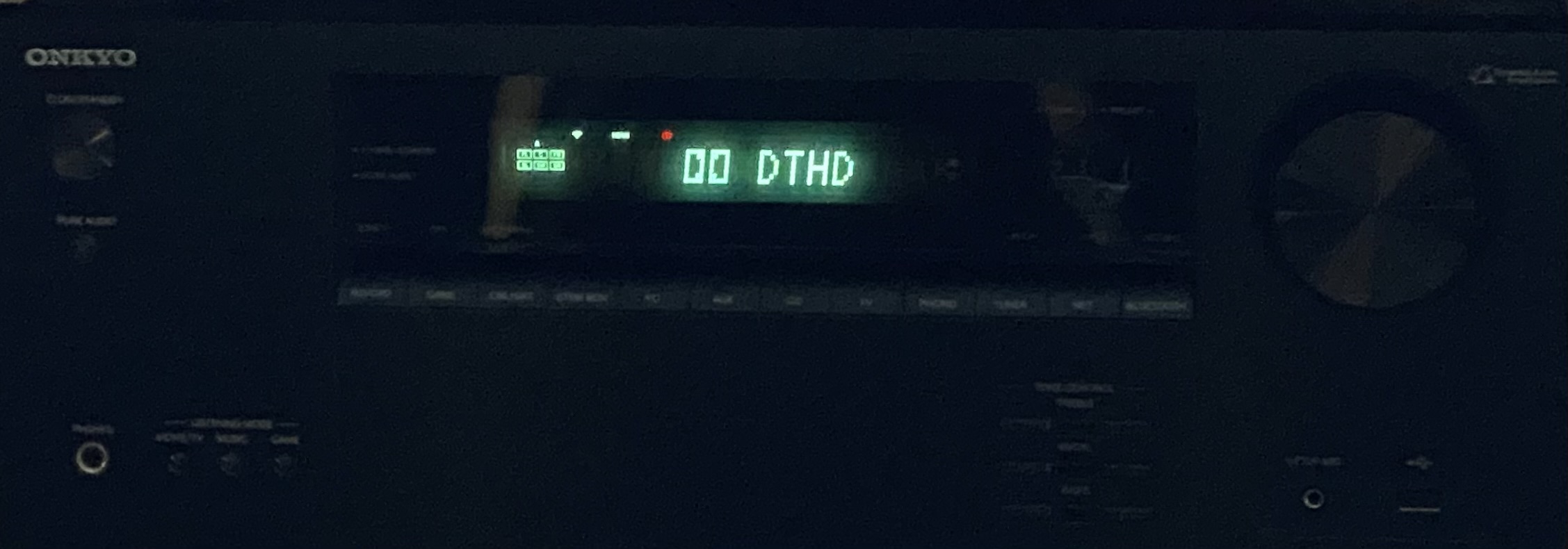

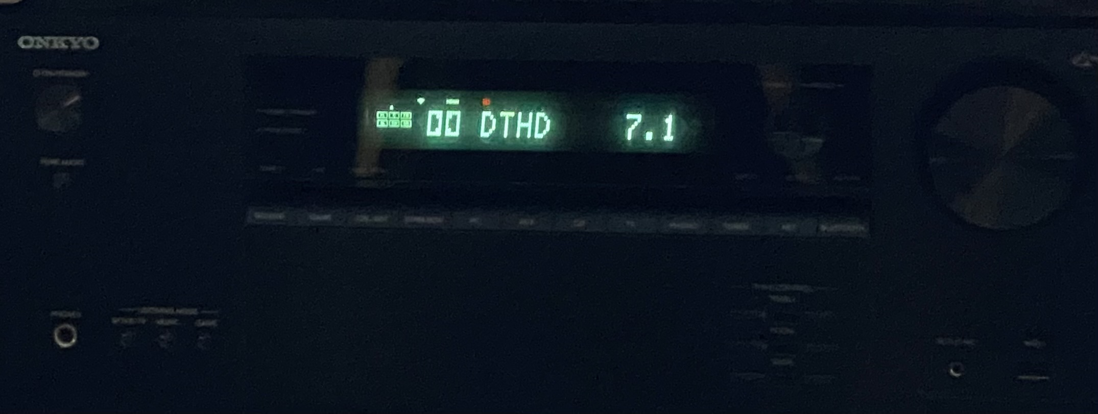

I actually have three Onkyos. There is also a Yamaha that we will not discuss here. I have an Onkyo TX-NR777, TX-NR696 and TX-NR6050. The 777 turned itself ON this morning and displayed an available Firmware Update. So, I ran it, wirelessly. I fear no firmware update or wireless connection.

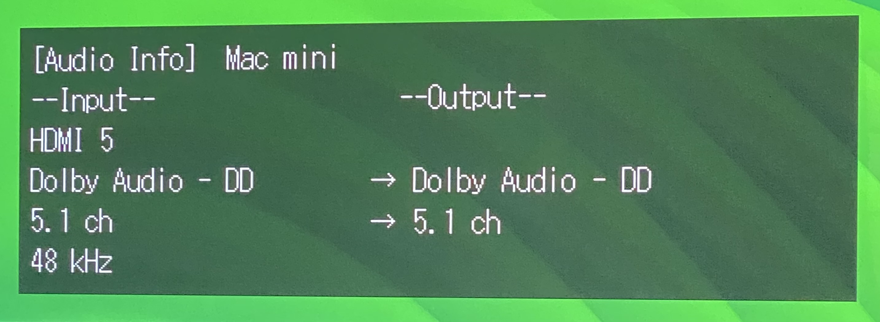

The TX-NR6050 is in the Main room and is used most of the time. For any signal using a straight decode, pressing the info button will display the incoming signal and input channels in the left side of the info box. The right side of the info box will display the selected sound mode and the output channels.

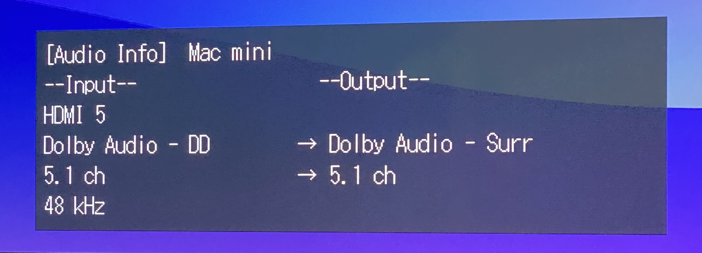

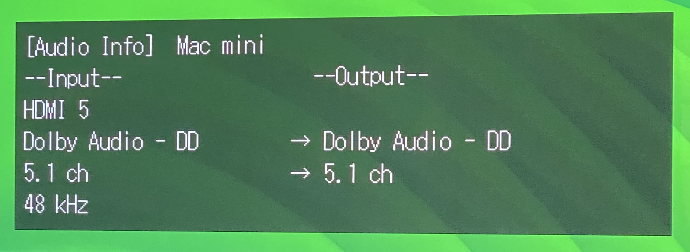

When using a straight decode of a DD 5.1 signal with a 5.1 speaker configuration, the input info will display Dolby Audio - DD 5.1 and Output will display Dolby Audio - DD 5.1. Use the Dolby Surround up mixer and the Output displays Dolby Audio - Surr.
Thanks....but I meant on the front panel of the AVR itself. Can you take any pics of what this looks like depending on what you're listening to?
Trebdp83
So, while playing a Dolby TrueHD 7.1 disc with a straight decode, pressing the info button will bring up the current sound mode…
Pressing the info button a second time will bring up the current input signal…

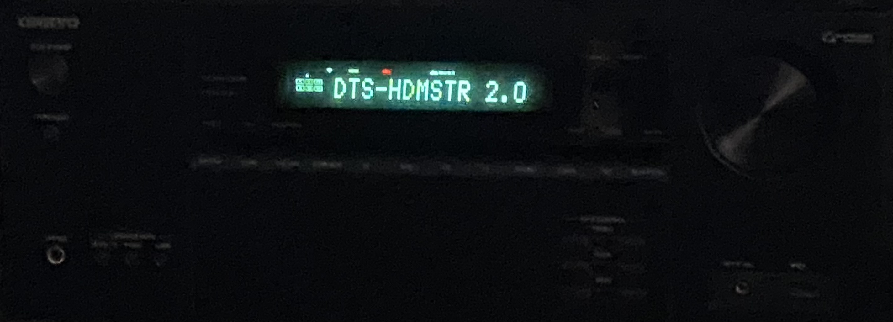

Is this just a new Dolby thing now, to not spell out "TrueHD" like on old AVR models? My 605 used to show the Dolby symbol and then the words "TrueHD" next to it, but the Denon 2800 only shows "DTHD" (like in the pics of your Onk above) when the upmixer is involved (without the Dolby symbol) or just like the way yours is when it's a straight TrueHD decode. It's the weirdest thing.
Do any AVRs use the "TrueHD" moniker anymore?
What happens when you play something with Master Audio -- does it say "DTS-HD" only?

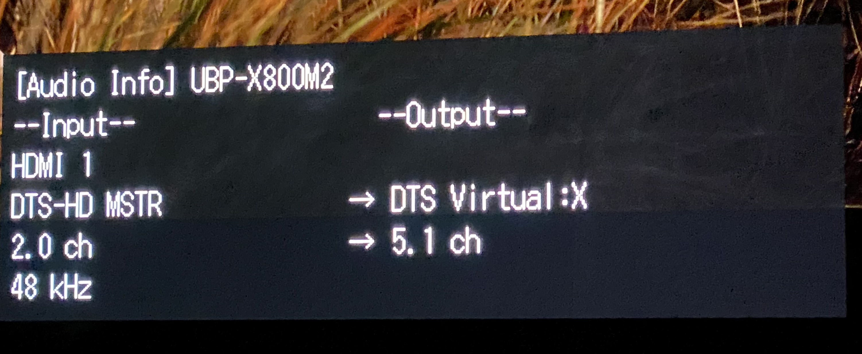

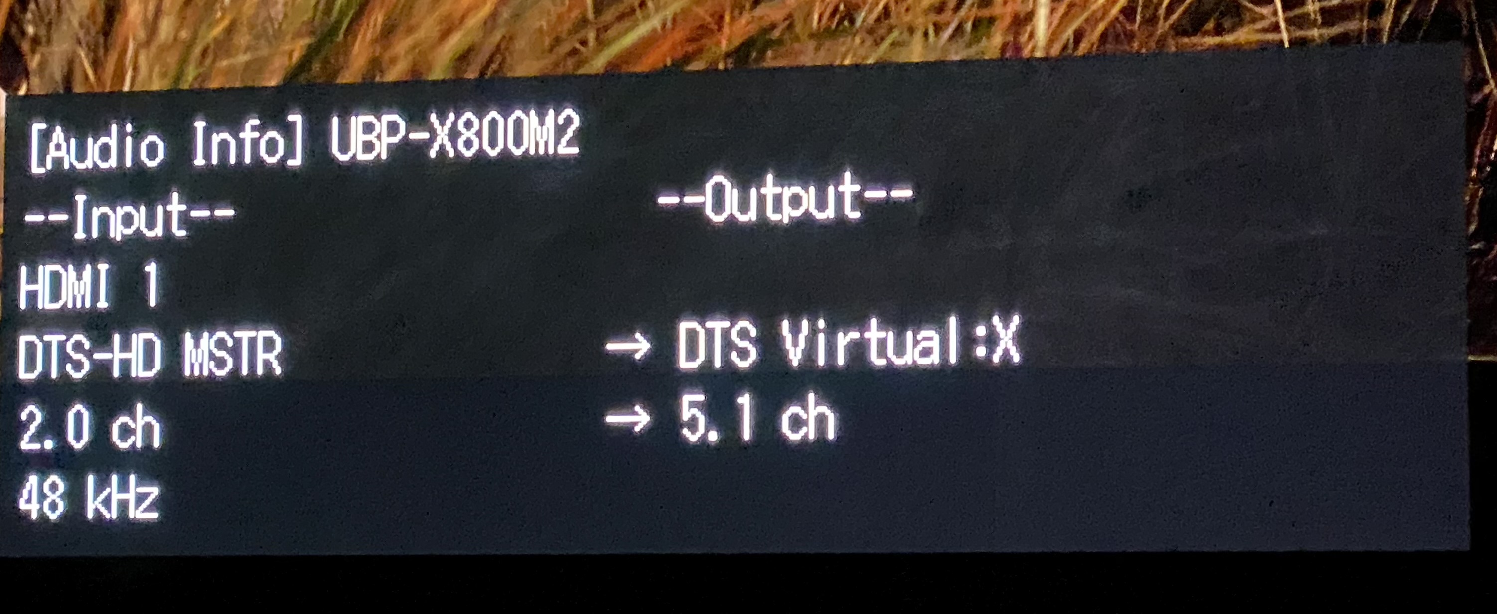

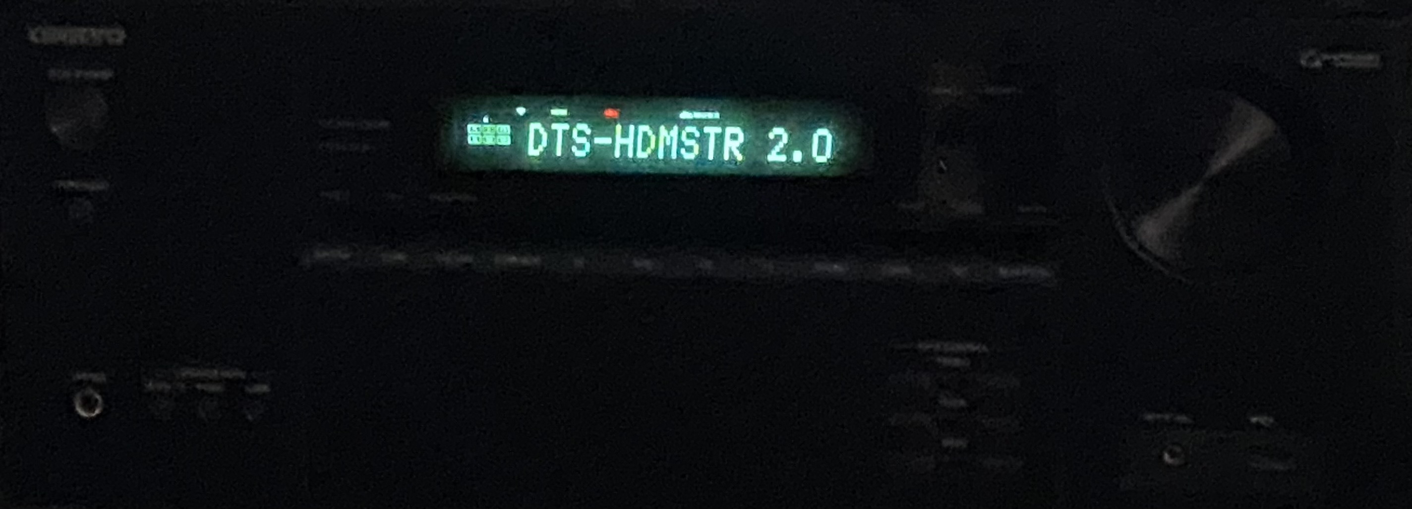

Here's another strange one, Treb....
You know how we have been discussing the way certain signals show up on the front of the Denon depending on what's being decoded....like when playing multichannel content with a Dolby track it will read "DD + DSurr" or "DTHD + DSurr" and when playing multichannel content with a DTS track it will read "DTS + Neural:X" or "DTSHD + Neural:X," and when playing 2.0 signals JUST the name of the upmixer will appear ("Dolby Surr" or "DTS Neural:X")?
Well, last night I threw in a Blu-ray copy of Exorcist III (Scream Factory Collector's Edition) and attempted to play its alternate DTS-HD Master Audio 2.0 mix as a test (the 5.1 track on this disc doesn't sound right, especially compared to Warner Bros.' original DVD version that contained a remixed Dolby Digital 5.1 track; it's almost as if Scream Factory collapsed everything into the center when they prepared the Master Audio 5.1 mix for the BD). I clearly selected the proper track from the setup menu, but the Denon refused to show "DTS Neural:X" on the display, instead showing "DTSHD + Neural:X" as if a 5.1 track was playing.
In other words, because I was listening to a TWO CHANNEL DTS-HD MA track, the Denon SHOULD have shown "DTS Neural:X" on the display ONLY, but it was showing "DTSHD + Neural," which is what lights up when MULTICHANNEL signals are being processed. I can confirm that I DEFINITELY chose the 2.0 track from the menu -- several times to test -- and even checked with the output of the disc player, which said it was sending the DTS-HD MA 2.0.
What made this even weirder is that I do recall, when using my previous Onkyo, the 2.0 mix forcing the AVR into Stereo mode (because it couldn't properly process DTS-HD MA 2.0 signals), so this would indicate that the Onkyo DID understand a two-channel signal was coming in.
Is this some kind of flagging glitch on the disc itself?
Here's what the back of the Blu-ray case looks like; it doesn't mention the DTS-HD Master Audio 2.0 track (just the 5.1), but it is available through the menu:
Trebdp83
There is no glitch. It is a lossless DTS-HD Master Audio 2.0 track, not just a two channel analog signal or digital PCM 2.0 signal. The Denon will always display the Dolby or DTS signal along with the selected up mixer. Here, it is a DTS-HD Master Audio 2.0 signal with DTS Neural:X as the selected sound mode. So, it will display as DTS-HD + Neural:X. My Onkyo displays the signal as DTS-HDMSTR 2.0.
Now, let me edit myself as I’m mistaken about Dolby and DTS 2.0 signals compared to multichannel signals. It shouldn’t display “DTS-HD + Neural:X” for DTS-HD MA 2.0 signals according to Denon. But, because the disc also features a DTS-HD MA multichannel track, it might be picking up on it. If you have a disc with a Dolby multichannel track and also a DTS-HD MA 2.0 track, you might see what comes up when selecting the DTS track.

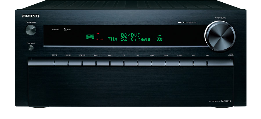

For me, while the porthole is almost completely useless. I like the look of the front of the unit overall. Fairly clean and I like the symmetrical design. I’m also just fine with pushing the display button to make sure everything is where I want.
The Onkyo that it replaced, an 808, was a great AVR, and one of the last ones that was thx ultra certified(iirc) and had gobs of power. It wouldn’t do Atmos, so it had to go.
Hold on a minute -- do you actually have a copy of this disc at home that you were able to pull up the info?
Secondly, I think there is something of a miscommunication with regard to what I was initially saying -- what I meant was, whenever I play discs with 2.0 audio mixes, whether mono or stereo, the Denon has been JUST showing the UPMIXER that engages....so Dolby 2.0 tracks read "Dolby Surround" on the display and DTS 2.0 tracks read "DTS Neural:X," ONLY.
When MULTICHANNEL soundtracks play, the Denon always displays the core track -- "DD," "DTHD," "DTS," "DTSHD," etc. -- WITH the upmixer designation next to it ("DD + D Surr," "DTSHD + Neural:X," etc.). That's the way it's been working since I installed it.
However, when I played the Exorcist III disc and selected the DTS-HD Master Audio 2.0 track, the Denon showed "DTSHD + Neural:X," NOT just "DTS Neural:X," which it SHOULD have, because it's only a two-channel mix.
Do you see what I'm saying?

Right. I had to correct myself because according to the manual, two channel signals should not display the incoming signal AND the sound mode like multichannel signals do. Why it is doing it with that disc I do not know. I do not own that disc and just put on another disc with a DTS HD MA 2.0 track. Onkyo models do not display the input signal AND the selected sound mode together at all. Press the info button and only the sound mode is displayed on the front panel. Press it again and the input signal is displayed.

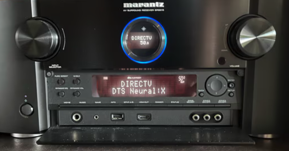

You could see if there is an SR7015 out in the wild at a good price and open the panel when watching movies to see the info.
Where does it say this in the manual? I didn't see it.
I realized, after I did some research, that the Onkyos do not show any sound mode info and input name, etc. together, at all, even when scrolling through the info menu (when the remote's button is pressed). That really is a shame; they need to fix this in future models, and have it show like the Marantz does in the example you provided below.
Yeah, I considered a Marantz with the drop-down panel, but I really don't like their AVRs for whatever reason; I mean, as I mentioned to Bill above, I can deal with the generation of AVRs like this 7015 above with its shiny control knobs and such, but I don't gravitate to them. However, if that's the only way to get a good readout from an AVR's display, it may come down to that.

And with Master Audio, I was told that DTS changed the way this codec is shown on the front of receivers now, as well; according to this report, no AVR will show "DTS-HD MSTR" or "MA" like they used to, instead just showing "DTS-HD." I can confirm that the Denon 2800 only shows "DTS-HD" with these types of signals.
Your Onkyo, however, is definitely showing "DTS HDMSTR" on the front, similar to how my TX-SR605 showed it. Strange.
