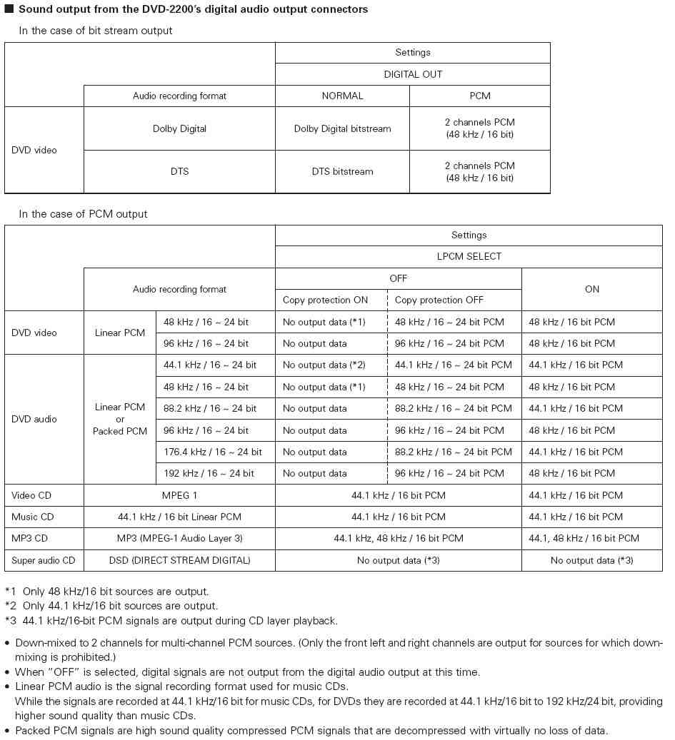

Attached is how the 2 settings effect the output signal on the 2200. If you set the NORMAL/PCM to PCM and LPCM to ON(or in your case PCM). This should allow you to output DVD-A as a downconverted 2 channel PCM signal over optical/coax digital connection(in the case of the 2200 its 2 channel 44.1 kHz / 16 bit PCM or 48 kHz / 16 bit PCM depending on the resolution of the recording)
