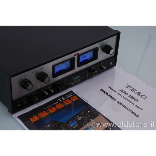

For those who’d like to get one, these are relatively plentiful on ebay(considering demand), but I can’t remember the models. Teac has 3-4 models, advent as well
