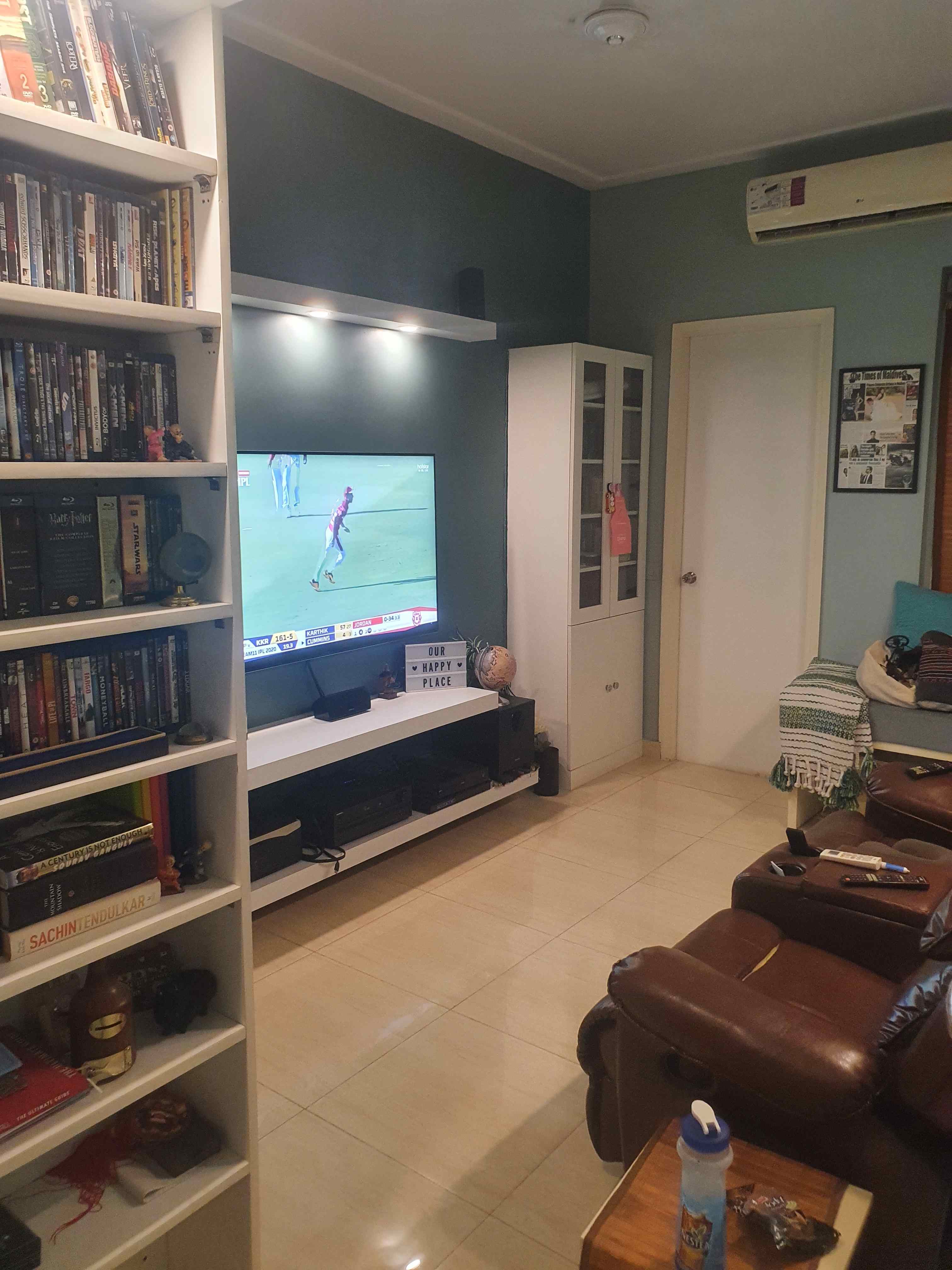

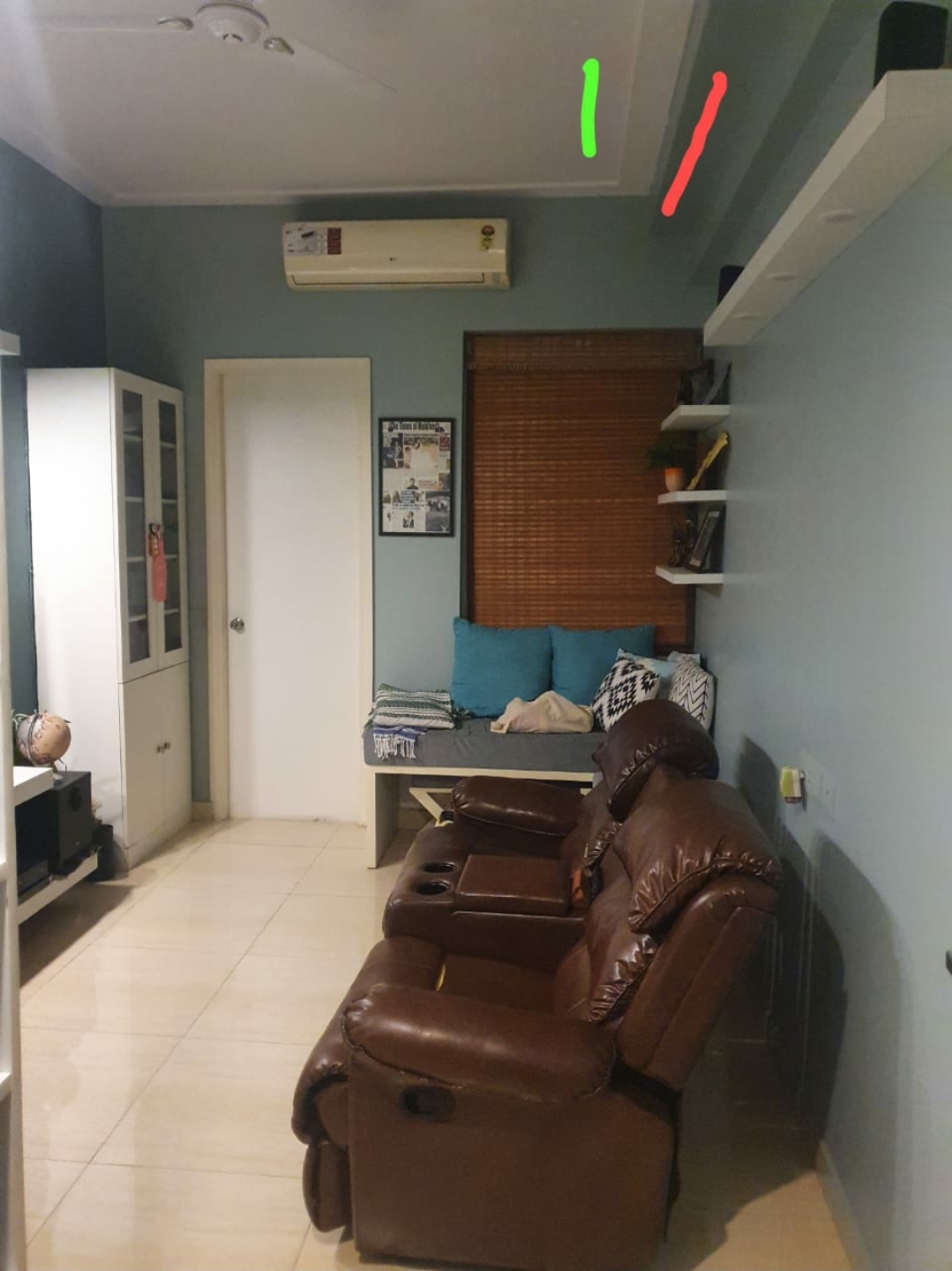

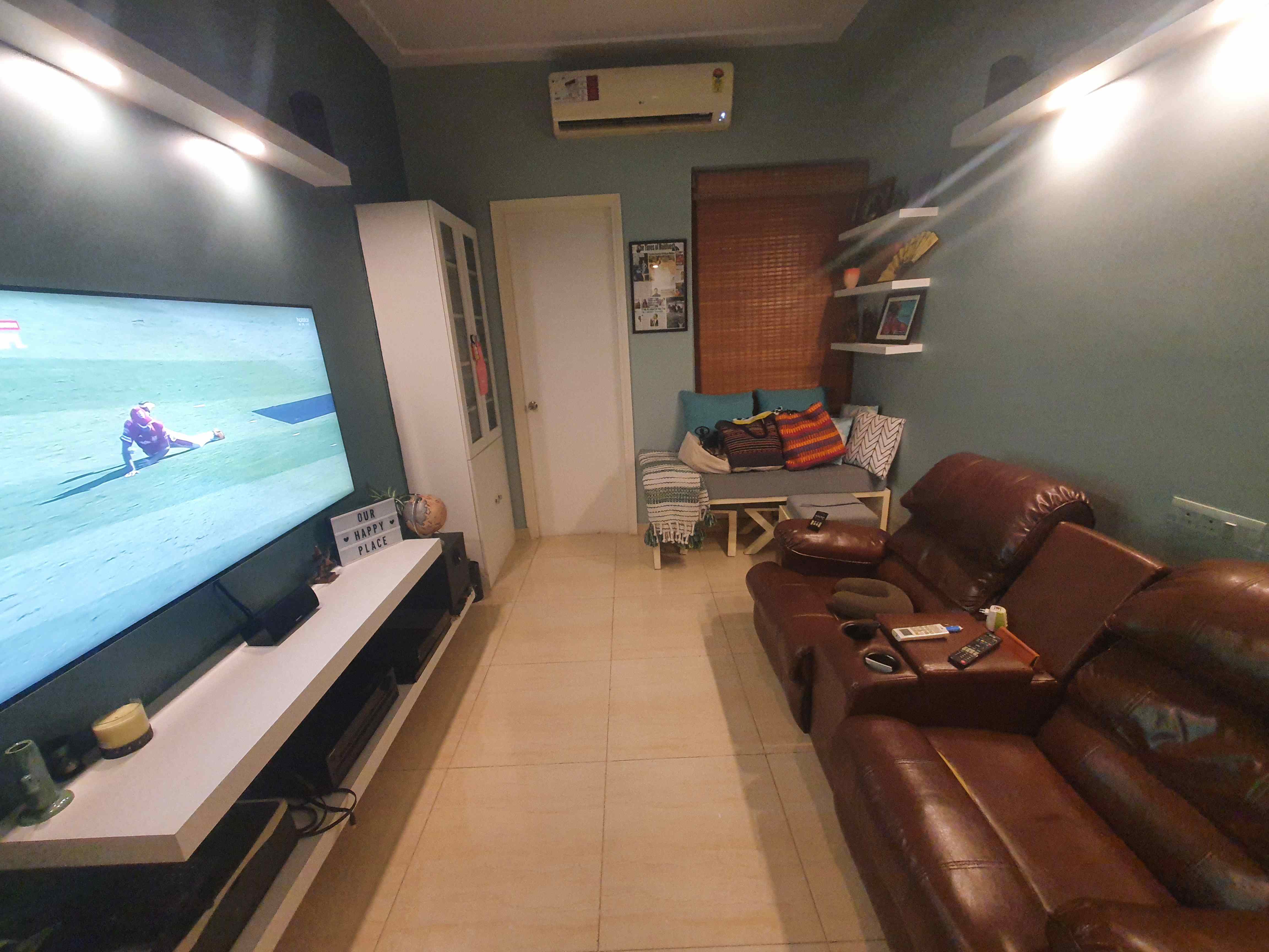

I am upgrading from an 8-year old Onkyo HTIB (5.1 setup), with the intention of going either 5.1.4 (preferred) or 5.1.2 (minimum) to enjoy Dolby Atmos. My room is on the smaller side (15x10 feet) and the biggest issue is that the main listening position can at most be only 1.5 feet from the back wall. To complicate matters further, I have a beam running through the end of my ceiling, which means that any top "rear" speakers can only placed about 1-1.5 feet from the back wall as well, which would make them almost directly overhead from the MLP (and not even close to the 30-55 degrees from the MLP that Dolby recommends).
I realize that this would not be an ideal position for top rear speakers, but is there any way a case can still be made for a 5.1.4 over a 5.1.2 setup? I am worried about losing out on the "forward-backward" movement of overhead sound, and regretting it later if I opt for only 2 ceiling speakers.
Would a hybrid 5.1.4 with a front height + top middle make more sense?
Whatever I decide is likely to be permanent.
I've attached photos of my room as well as the layout (scribbled on paper, but hopefully legible!) for reference. Distance from the MLP to the TV is about 8 feet.
