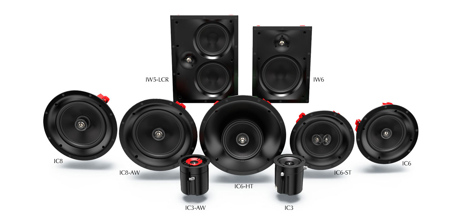

The light is a 90mm diameter (so 3.5") - I measured it wrong.

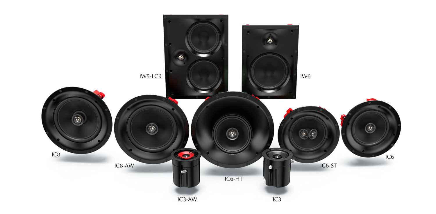

Compatible speaker:
Martin Logan IC-3 (the tiny cylindrical one bottom right)

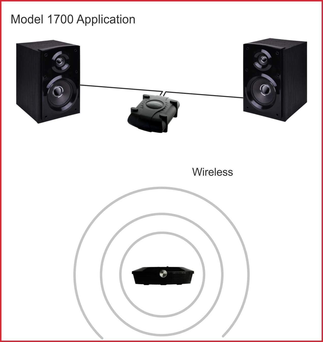

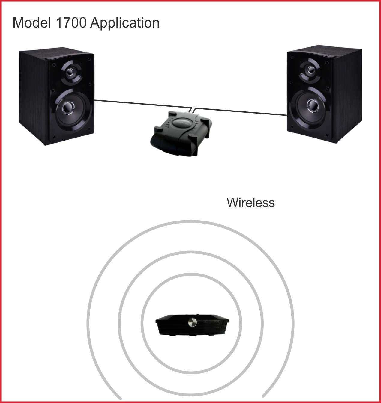

Wireless speaker conversion kit:
Amphony 1700 Wireless Speaker Kit
(this takes a speaker-level input to the transmitter, then transmits to the receiver which is also a stereo amp)
Compatible speaker:
