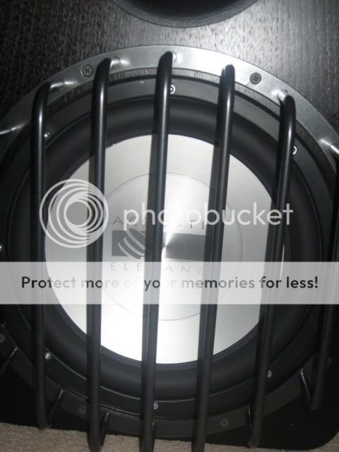

The air moved by some subs can be very turbulent. Nothing is wrong with a grill, but subs don't normally "enjoy" grills either.
billy p
billy p
I like this option...
...:D.
...you still have full view of the driver and it offers up some protection therefore...on or off won't matter much...;):).
...:D.
I knew it was only matter of time before you showed us a pic of your sub again all you need was an excuse.:D Grill on or off doesn't matter with the sub the grill doesn't have enough mass to be an issue.
