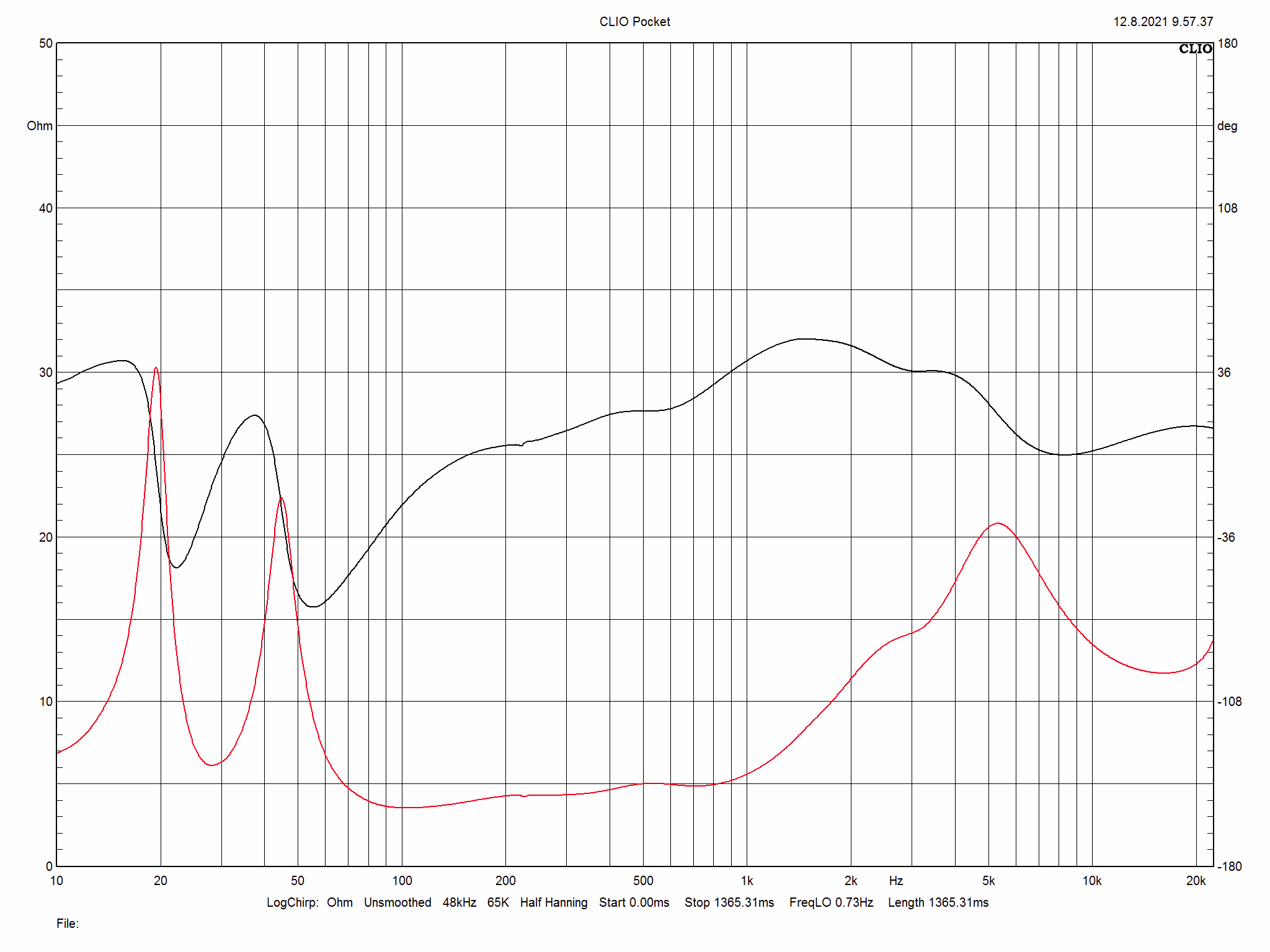

A foreign language (Czech?) review of these speakers does show both a frequency vs. impedance (red trace) as well as a phase angle vs. impedance (black trace) curve.
Overall, the impedance doesn't look bad, it doesn't go lower than 4 ohms. See the red trace in the 80-300 Hz frequency range. But the phase angle does shift rapidly over that same range. The phase angle units, on the right side of the graph, make it hard to guess the range of angles over that frequency range. But I'd guess that it isn't small. Low impedance combined with a large shift in impedance phase angles, over the same frequency range, is a sure sign of speakers that are difficult to drive. So, it's possible that these speakers might be a difficult load for your moderately powered Marantz AVR to drive. But I can't say that for certain.
If you get those speakers, I'd try running them in stereo with your Marantz. But run them at high volume with some caution. See what you think about their sound.
