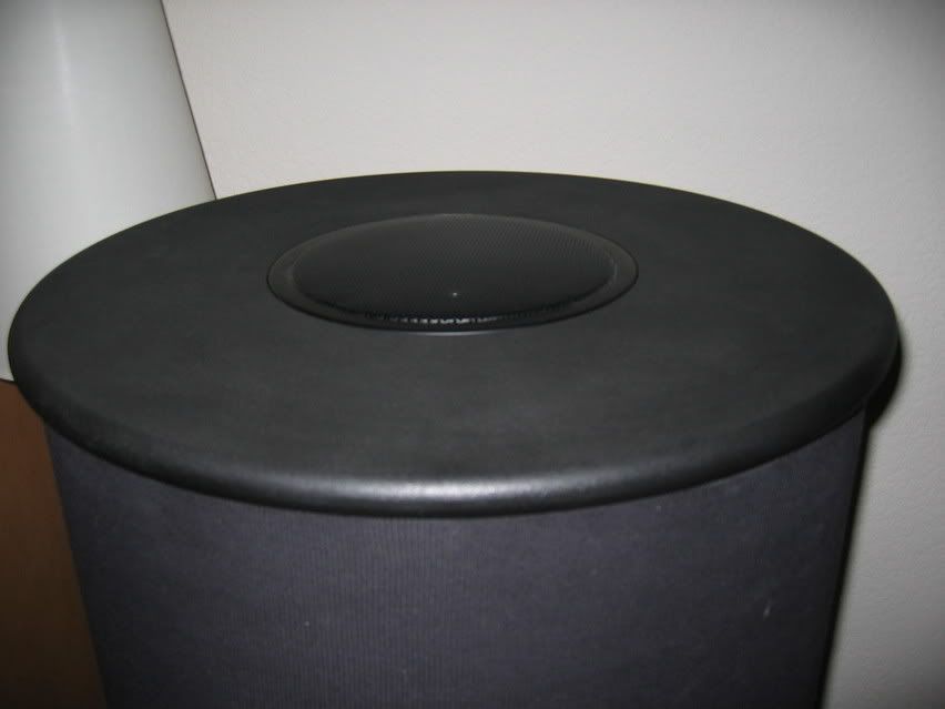

I recommend the driver on the bottom and the port on the top. You can see here what my buddy did:

Here is what my buddy said:
The tempest design is 6.1ft^3 4" flared port which I
think is 11" long in the mid section but I will have
to double check on that. You could probably measure
it on the sub. I used 18" sonotube which was the
smallest you can go for the 15" tempest. I also used
3 layers of 3/4 MDF for the endcaps. I'll try and
find the email from Dan Wiggins himself explaining the
design.
1
1980supreme
thanks a bunch man. that looks pretty nice. what's the tube itself finished in?
i'm not sure whether to carpet, or soak some veneer and bend it.
it sounds like i'll be happy with anything from 6-9 cubes.
j_garcia
j_garcia
It is finished in carpet. I have been pondering what to refinish it in too, but in my current setup you don't even see it, so I'm in no rush.
I have absolutely no problems with port noise either, and this thing can really move air :)
