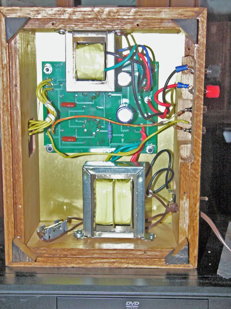

Here's some pics of the finished mono amp

More pics
I screwed up the photobucket link yesterday and only did one pic. Trying again
