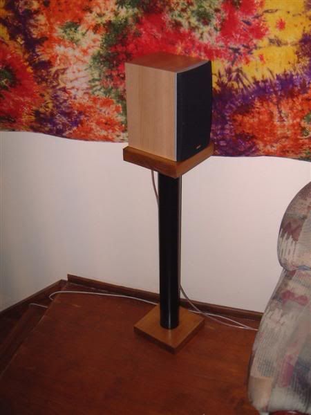

I built these a couple of weeks ago:
(Click for high res)
They are made from PVC tubes with diameter of ~3", height of about 30", sand-filled for stability. Cost me all of $40 in materials and a couple of hours in the garage :D
Inspired by this project:
http://www.tnt-audio.com/clinica/stubby_e.html

The bottom base is too small, IMO.
