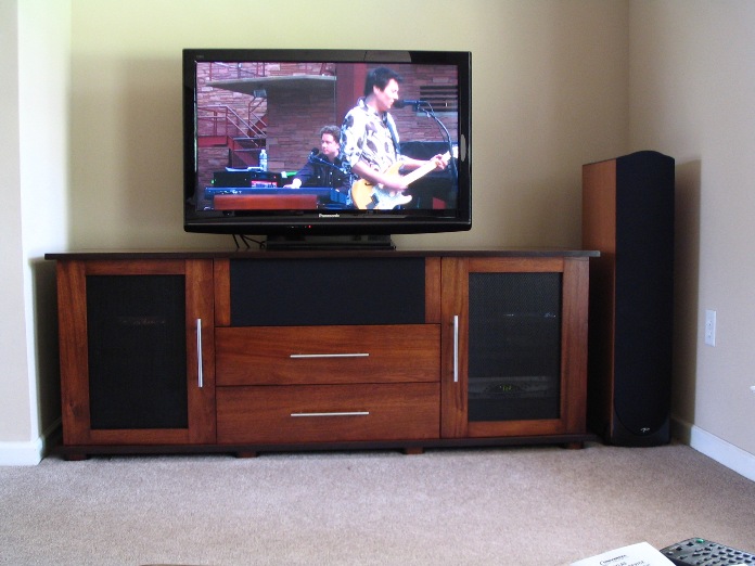

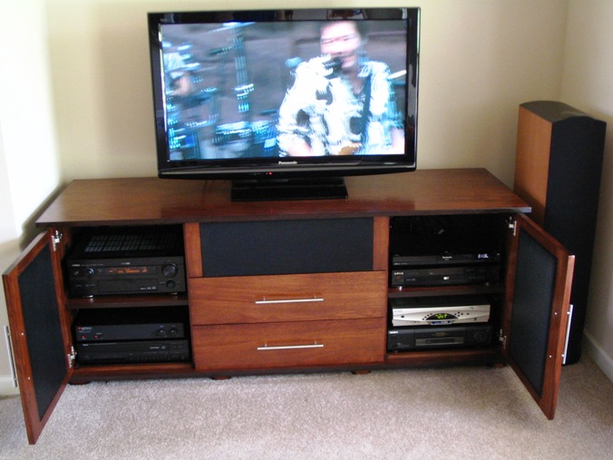

Hello Everyone,
I have received a good bit of advice on here and thought I'd share some pics of the results. The 42" Panny on top was recommended by several members, and it's been great. The Entertainment Center is made of Mahogany with Wenge strips on the top and bottom edges. I followed someone’s advice and drilled a hole in the back of the center speaker compartment to match the rear ported center speaker and it sounds great. My only regret is that my Cable box/DVR is silver and not black (thank you cable company).

Very nice!
Did you use plans? If so would you share?
That is exactly the kind of cabinet I was thinking of building since I'm WAY to cheap to drop 1k on one I like.

Thanks. I did draw up the design, but it's on a big poster board. Give me a day or so and I'll get them in a usable form. I can tell you that the top, bottom, and sides are from one sheet of Mahogany plywood, the front pieces are from 1x6 and 1x8 solid mahogany, and the insides are made from one sheet of birch plywood. I ordered speaker fabric for the center speaker compartment, and the two doors have perforated metal sheets that I ordered from Studio Tech. They make cabinets very similar to mine, but I wanted to save money as well as make custom dimensions and features. Since my cabinet is a different dimension than theirs, I used their taller audio cabinet metal sheet and cut it to size. I’m sure you can source this somewhere else, but I took the easy road, and by ordering a couple of extra things got free freight.

Excellent job, do you feel like making more units? I'm sure that at the right price a lot of members here can keep you busy 'till rapture..lol. Oh, by the way where is your left speaker?
Tape and spray ;) I've just done that to bedroom's LCD.
Choose a matte black as it will look much better than the glossy black. Go with 3 or 4 light coats and it will look excellent.

I agree about A/V furniture being too expensive. The manufacturers will make it out of MDF, slap an A/V designation on it, then price it as if it was solid hardwood!! Ridiculous! Plus, with "assemble yourself" joinery, it's never as strong as proper cabinet joinery.
I was also wondering where your other front speaker went. I'm no expert on acoustics, but the placement of your left front leaves me wondering about the effect on your SQ...

Thanks for the kind words. Unfortunately, life is full of compromises, and that’s probably best illustrated by my living room. Ideally, my system wouldn’t be in a corner of the room, but just to the left of the cabinet is a fireplace. The left speaker is just to the left of it. The Yamaha receiver does a pretty good job of compensating for the speaker placement. If you are on my sofa, which is at a 90 degree angle and in front of the fireplace, the left speaker is actually in a better location than if it was next to the cabinet. I must say that I listen to music and watch sports much more often than I watch movies, so it’s not quite as annoying to me. I would prefer that I had the entire wall to use, as a fireplace in south Louisiana isn’t very important to me, but people down here still want them!

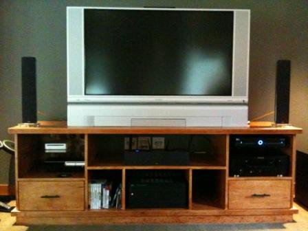

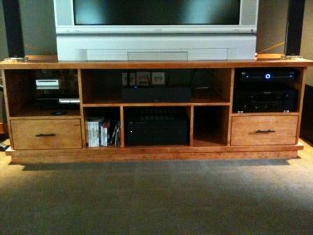

Thought I would revive this thread with a couple of pics of the console that I finished on Thanksgiving day. The ugly tv and small center speaker distract from the picture but they will both be replaced soon enough with a projector/fixed mount screen and a significantly larger center channel (along with towers for the L-R). I may build a piece to block off behind the center channel if the new speaker doesn't hide the wiring mess behind it. I am also thinking about building a couple of doors for the bays to the right and left of the center component shelf. I took the pic with my iPhone so it doesn't really do the console justice - it looks better in person.
The entire center is built out of solid maple hardwood, with maple ply only being used for the top and bottom. I did all dadoed and glued joints. I have never stained maple before and I can see why many people just leave it in it's natural state. It turned out a bit blotchy but not too terrible. All of the equipment bays (2 sides and one center for the amp) are 19-1/8" wide to accomodate Middle Atlantic rack rails in the future if desired. The center speaker slot is large enough to accomodate a Paradigm Studio CC-690 speaker. One of the features that I think worked out better than expected are the cable pass-through holes in the back of the side component bays. Two sets of four 2" holes on each side allow for segregation and management of all power, speaker and interconnect cables. They were a bear to drill and not really thought out in advance but turned out very nice. You can barely catch a glimspe of them behind the Wii on the left hand side. Anyway, hope you enjoy the pics.
