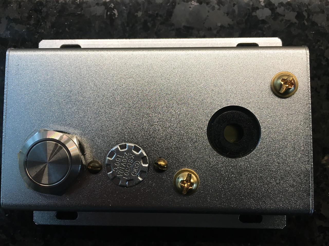

I have mine come on with the relay that starts the three main speaker power amps. In your case the projector is switched with a remote, so I would use a current sensing switch in the projector feed to start the fan. Fantech make these also, but I linked a good one at reasonable price. That way your fan will come on when you start your projector. As far as a temperature alarm, I needed one to satisfy the building inspector for the heat shield I had made for out outside kitchen. I could not source one anywhere, so I designed and built my own. There are loads of smoke alarms, but they are no use over a barbecue!
Below you can see it in place on the right under the hood.
If you think you really need a temperature alarm, I guess I could make one for you.
