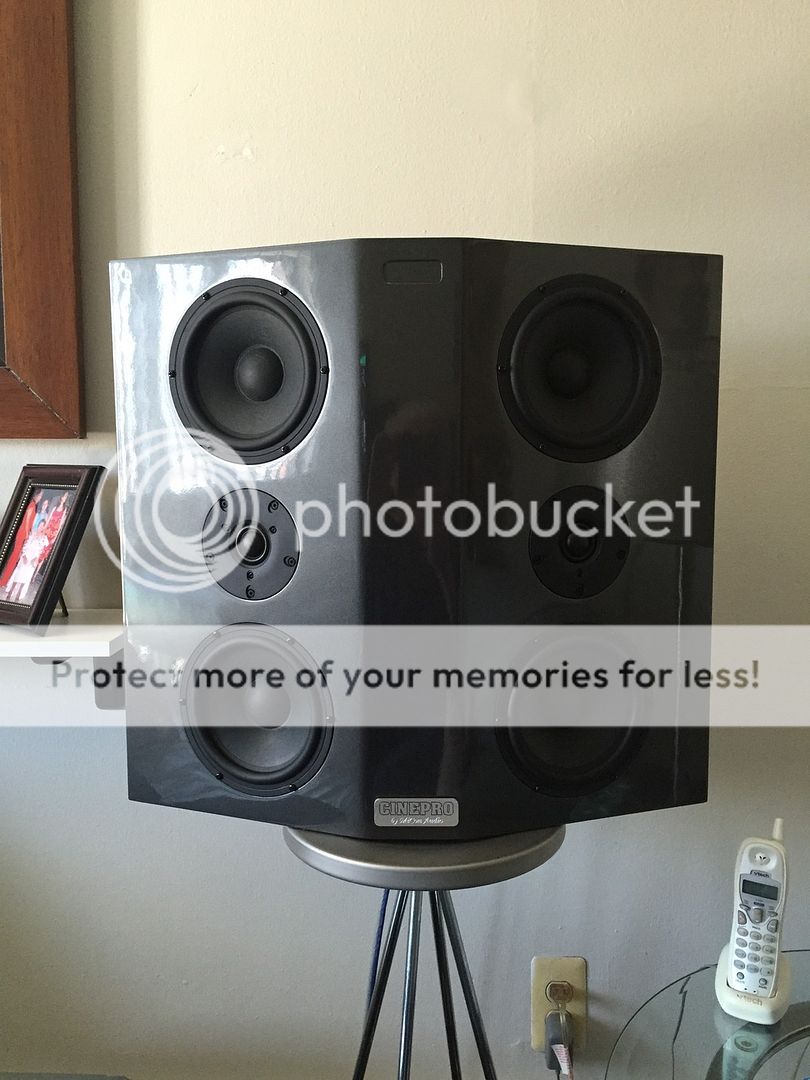

I am using bipoles now. I had so many rear setup over the years. It all depends on the room. True surrounds I can't have since there is no way to mount them properly (small apartment living). I do think my last rear setup was good. Monopole for rears and custom made surround towers with side firing woofers. It's tough to set up a rear section if you don't have the proper room.
Last rear set up. Worked for me.
Now I am using these. I went from 7.2 to 5.2 for now. One day I will figure out how to wall mount them. At 62# it's not an easy task, besides I do not want to ruin the nice automotive finish on them.
